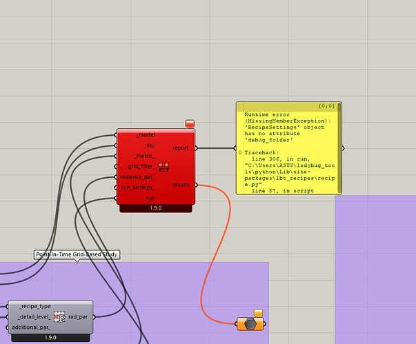

I have the exact same issue as @Nimafo, however the above mentioned release/solution has not fixed my issue. What shows up now as the problem, instead of the message shown above, is “1. Solution exception:‘RecipeSettings’ object has no attribute ‘debug_folder’”. I have attached a screenshot below and would greatly appreciate any help/guidance on this matter.
I now get the same error. This script was working fine, but since updating ladybug tools, I get this error. I don’t use the HP recipe settings so I can’t change anything there.
