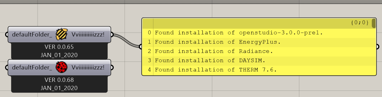

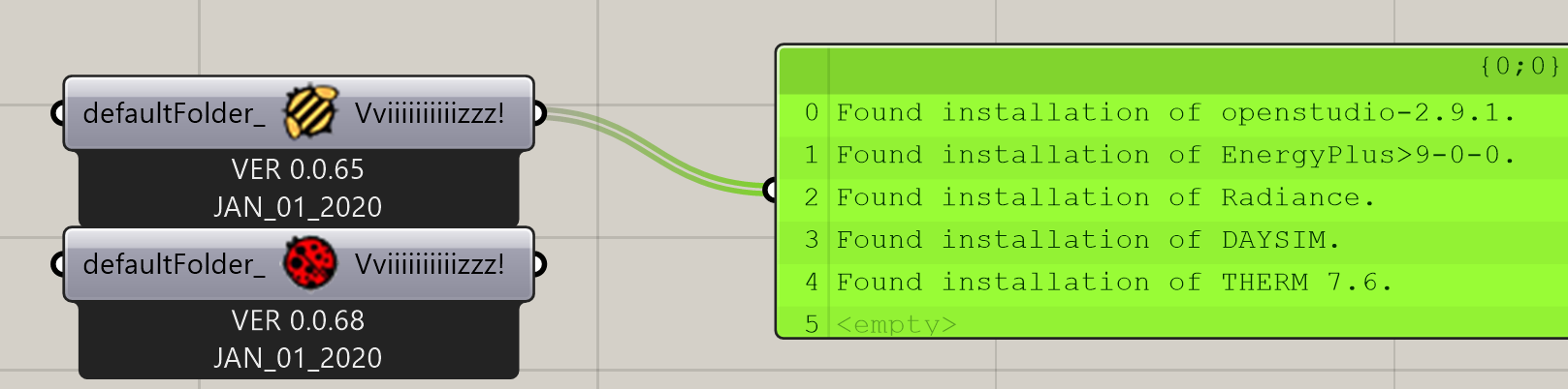

To put it in perspective, recently, when starting a new file in Grasshopper, Honeybee wouldn’t recognize Openstudio. I found out that When I changed the default installation folder from “openstudio-2.9.1” to simply “Openstudio” it did, so I changed it.
But then this happened: Openstudio would stop working when running simulations in those older repository files, and throws that error I mentioned
I managed to “fix” this issue by changing the name in the default folder back from “Openstudio” to “openstudio-2.9.1”
There’s something to be mentioned as well: I happen to have both openstudio-2.9.1 AND openstudio-2.9.0 currently installed. (no reasons, really).
I have the exact same message. And have solved the issue.
It happens with the simple Energy Balance example file. And it was easy to fix (once I saw this post and it clued me into where to look at my problem): I needed to ensure that HB was finding the correct version of Open Studio, and I even needed to delete the residual directory that my Open Studio uninstall command had not removed from the C:\ drive of my Windows machine.

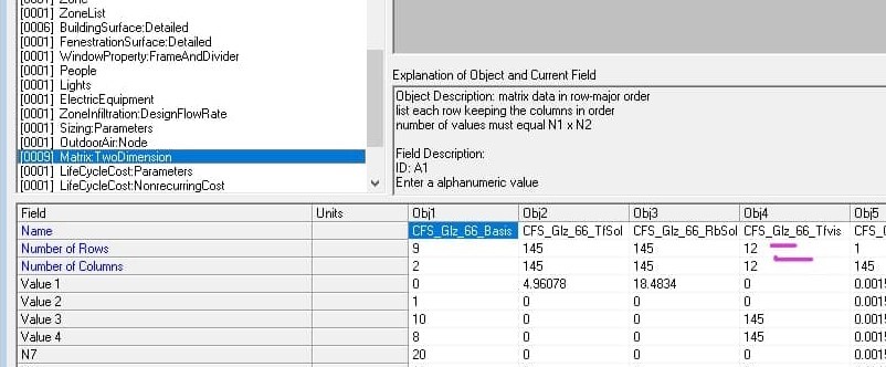

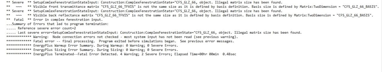

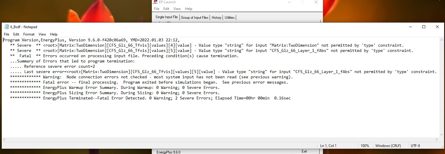

But I installed LBT1.3 before, I work with EP 9.5 too.
actually I dont want to use LBT for now. I just used EP and wrote the numbers by myself again, the error didn’t solve.
Im not sure, maybe it is raleted to Martix!??!
