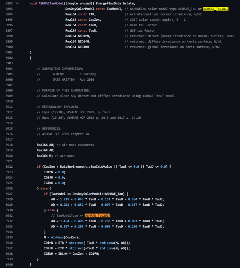

I have the same problem as you, I’m wondering if you find out why the ASHRAETau2017 is not working?
I digged inside the EnergyPlus code and I think it might be somewhere in there, but I’m not sure…
