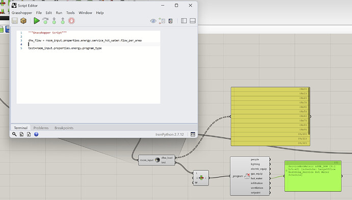

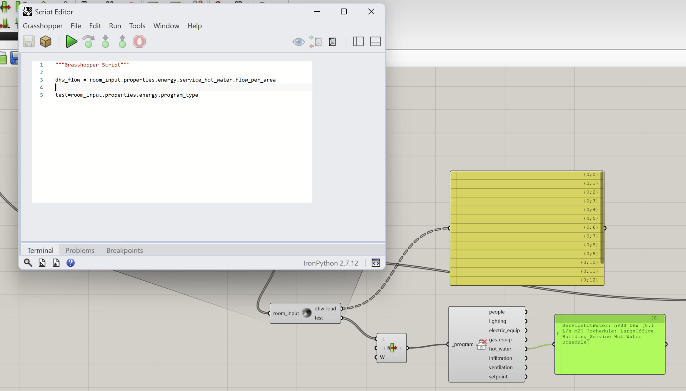

Hi - I am trying to access the service hot water load of a given room with the python script options and I cannot figure out the syntax
I am trying this line:
dhw_flow = room_input.properties.energy.service_hot_water.flow_per_area
The script seems to run with no syntax error but theres no output…? See screenshot below.
I can see the program has a hot water definition but for some reason the script line doesn’t pull it out?

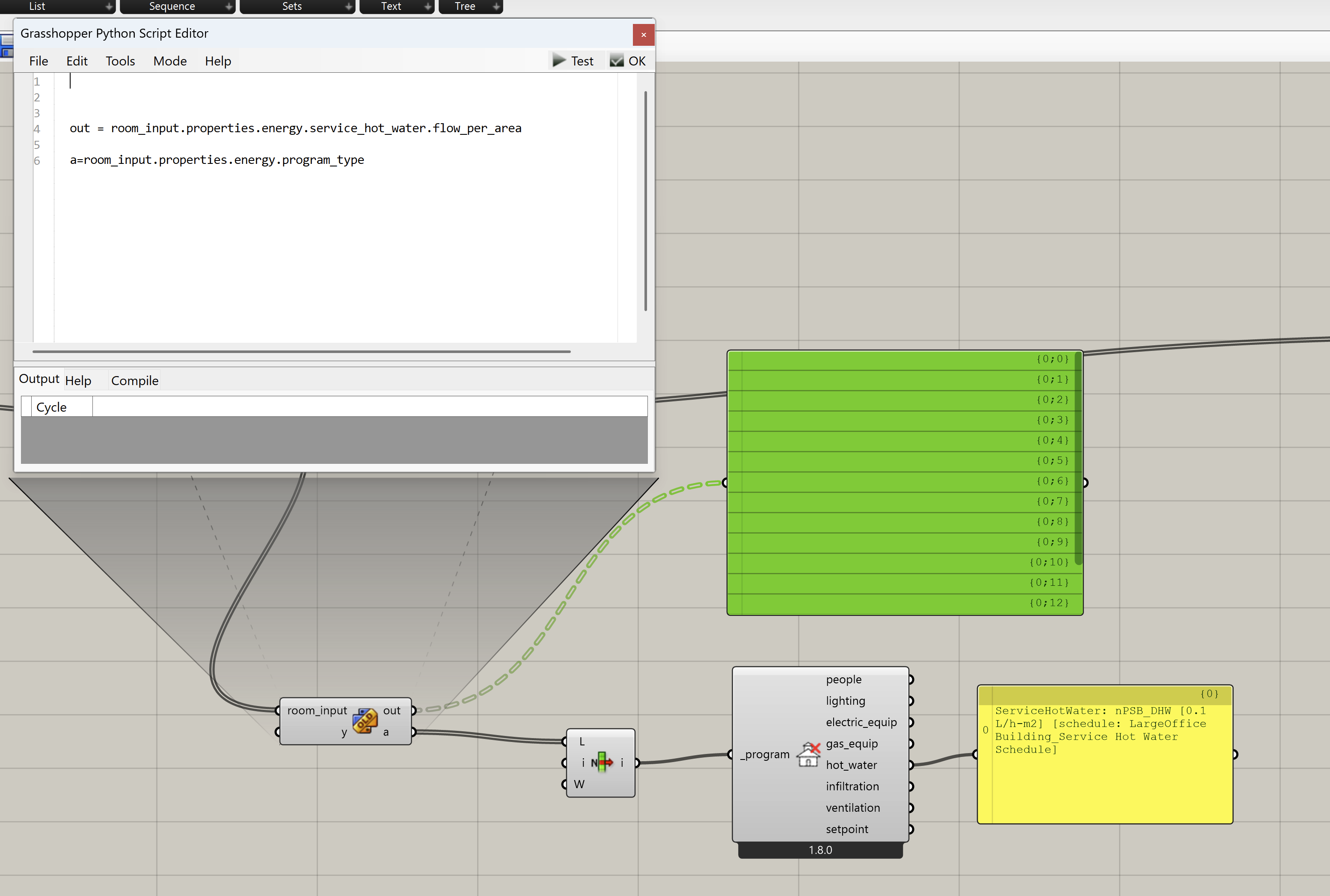

Thanks Chris! I implemented in GHPython but same issue seems to occur:
Actually I got it to work
I think theres some weirdness with renaming output variables in the GHPython component. I did a few cycles of renaming and testing the script and eventually everything came through. Not sure what might be happening.
