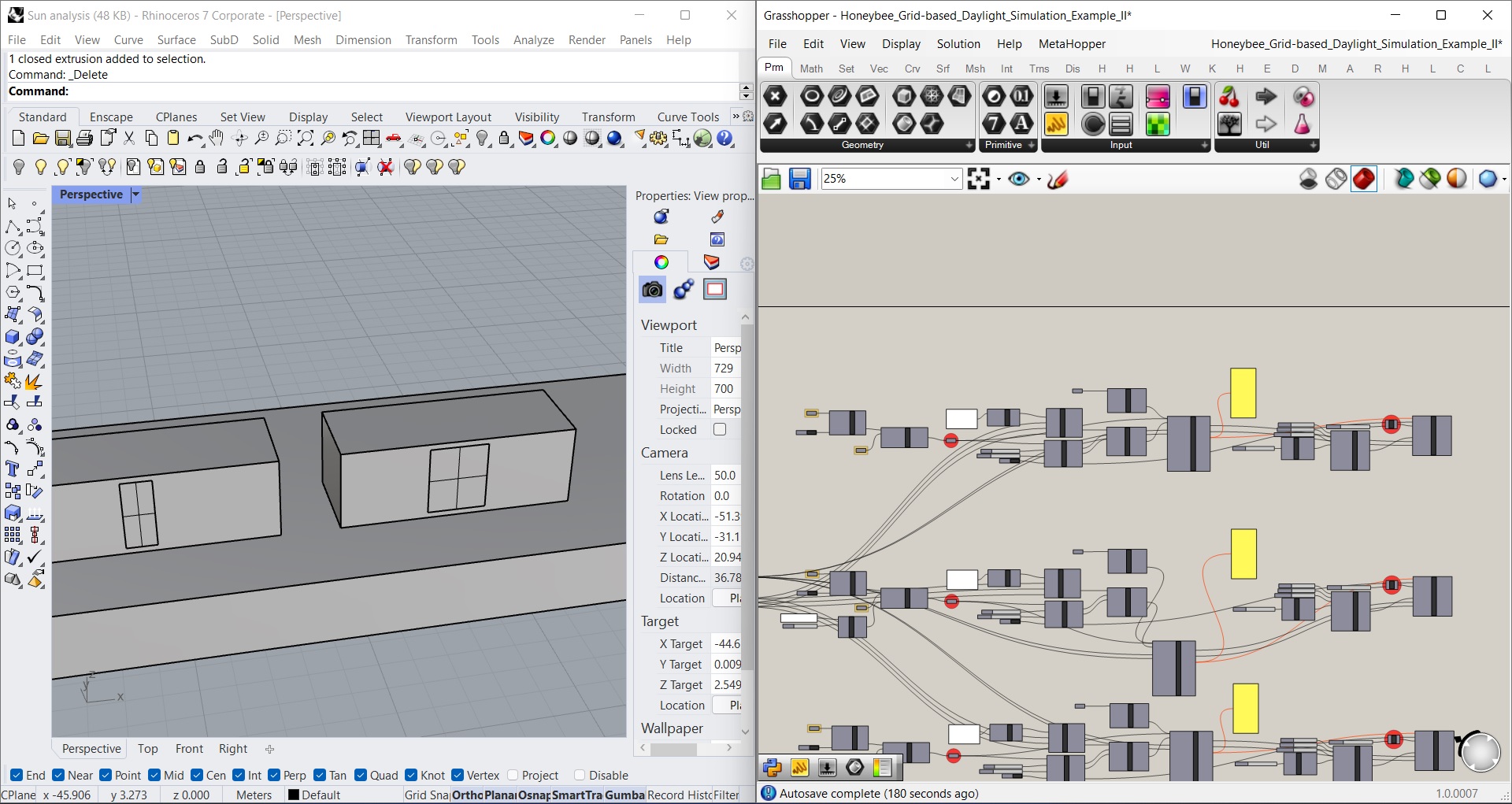

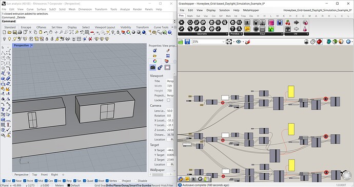

this image show how my sun analysis looks like

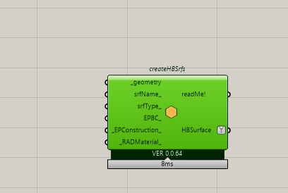

hi you should add them as surfaces in 0.64
In 1.4 you have separate components for shades
thank you Kon, but there is no any area that i can connect honeybee surfaces as shades, that was my main issue
