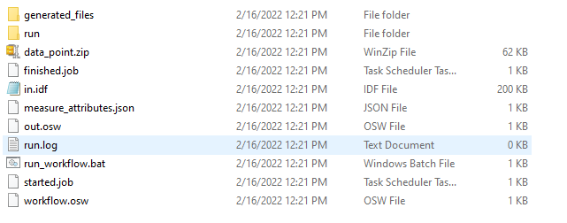

The plot thickens… there is no OSM file that gets created, which way may be why its invalid. Not sure why, this is a single zone model used to test the script. and the IDF gets output.
