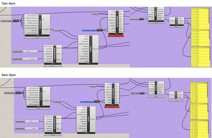

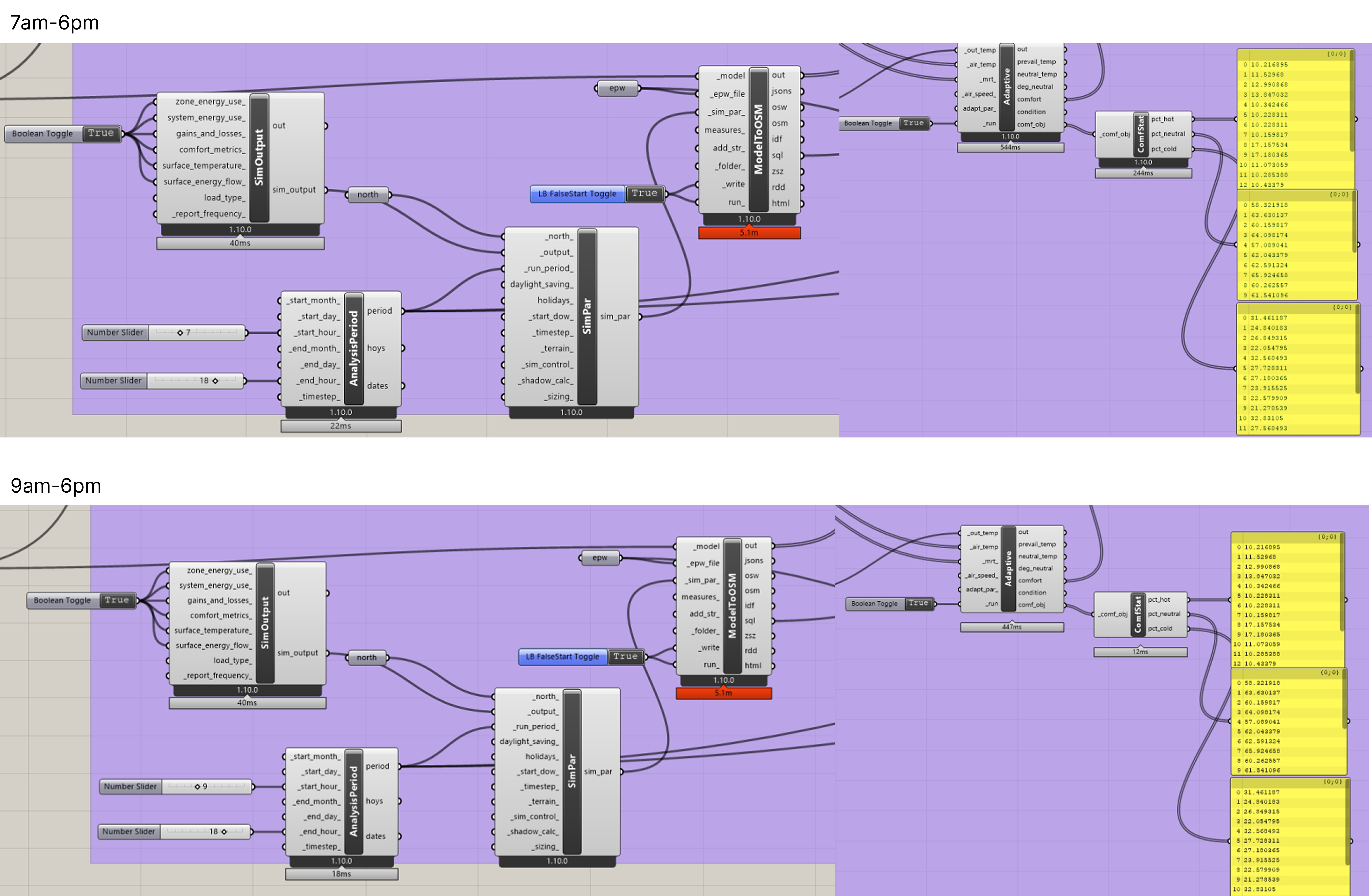

I’m running a comfort analysis in a school building and the AnalysisPeriod doesn’t seem to be working with ModelToOSM.
When applying the period 7am-6pm the Adaptive Comfort results are the same as the period 9am-6pm.
Is there something wrong with the way I’m applying the Analysis period?
Complementing, in the html of the simulation, it informs “Values gathered over 8760.00 hours”, which I understand that it means that the Analysis Period is not being applied.
Did you try using the apply analysis period component? I am not dure if it’s needed in thid case
EnergyPlus cannot run for a time period shorter than a day. So the hour inputs are ignored when connecting the analysis period for the run period. Only the dates are used.
If you need to apply an analysis period with hours like this, you must do it with the LB Apply Analysis Period component on the data collections after the simulation is run.
