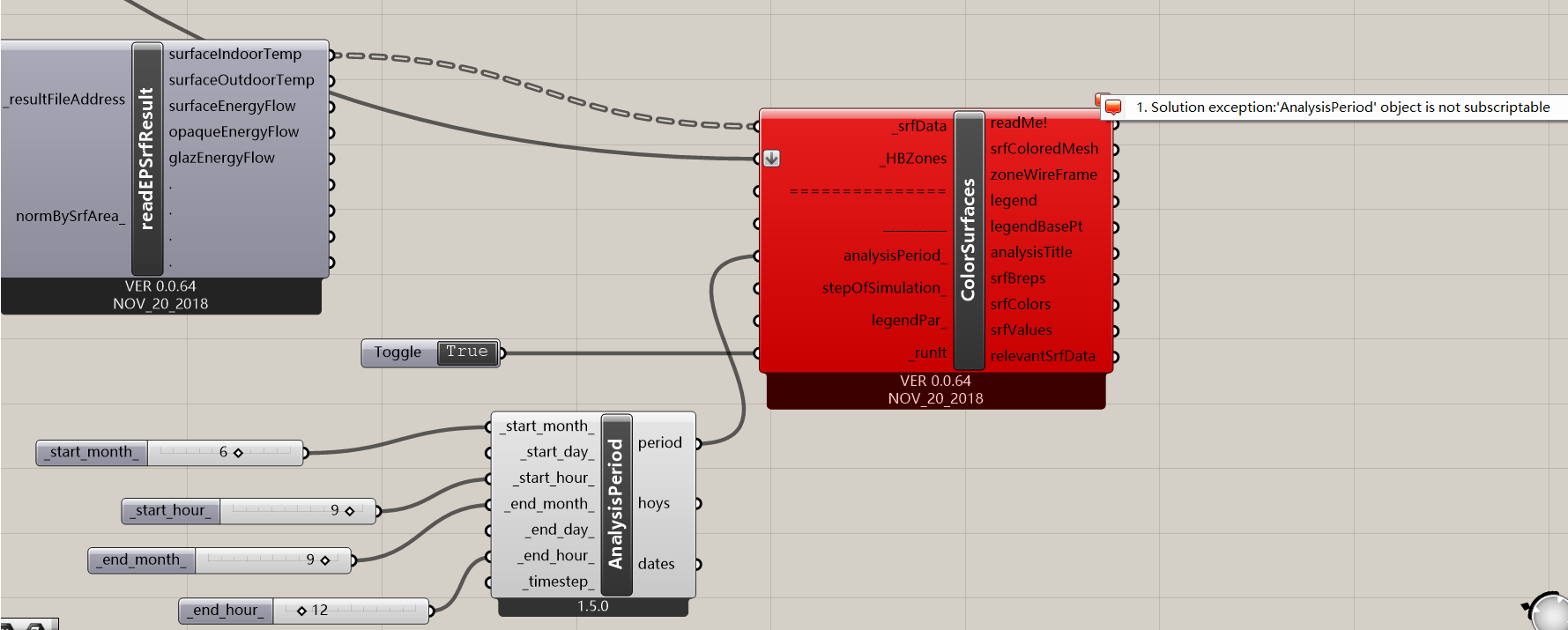

Hi,there.I have no idea about what ’ wrong with my work.I just try to set the analysis period to several months of a year. If anyone knows ,please tell me. Thanks!
Welcome to the forum @dada1!
The issue is that you’re combining new (ver 1.X) with old (ver 0.X) components and they don’t work together.
I’d recommend only using new components.
Cheers,
Charlie
Thank you very much!!! The problem has been solved ! ![]()
