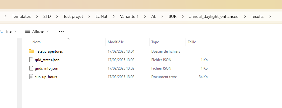

I try to use the annual daylight results to control lighting in energy simulation.
The annual daylight simulation seems to work perfectly fine (I have daylight autonomy results) but there is no .ill files (see picture below). I need them to plug at the input of the HB Daylight Control Schedule component.
Is it normal ?
Any idea to solve this problem ?
The results should be under the __static_apertures__ folder. The recipe creates a new folder for each state of the windows.

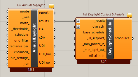

The description of _results in HB Daylight Control Schedule has not been updated for some time. The newer version of the the annual daylight recipe will create a results folder (the one you show in the screenshot) which you can connect to the control schedule component – so you want to connect the results from HB Annual Daylight.

So if I understand well, I just have to connect the result file at the input of the HB Daylight Control Schedule and it will take into account automatically the sun-up-hours.txt and the results in the _static_apertures file ?
Yes, just connect the two components like below.
