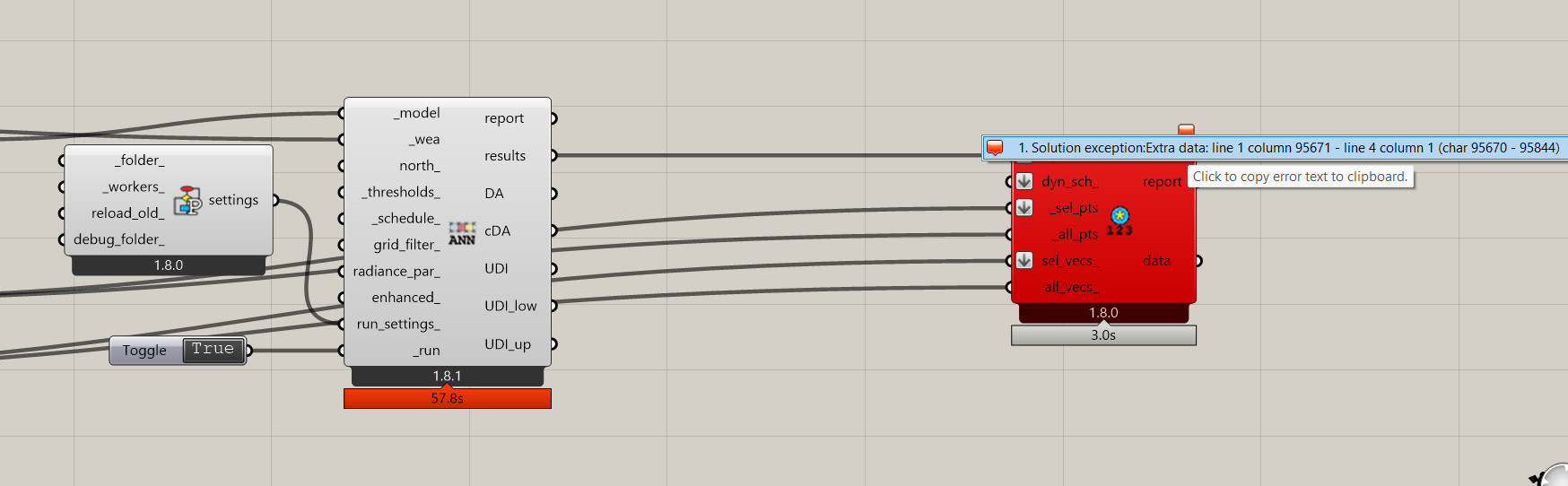

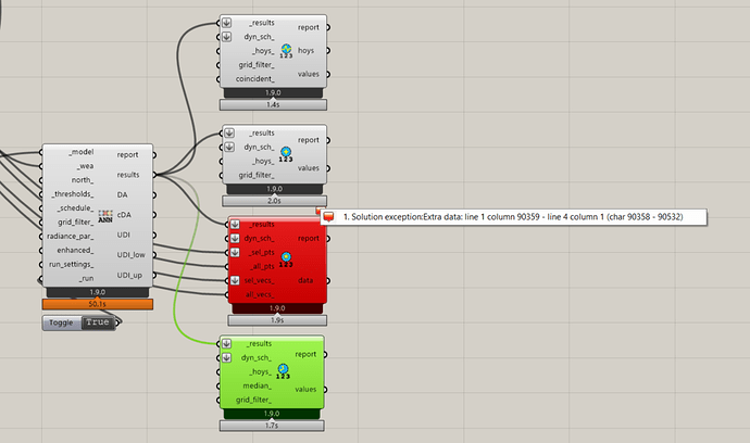

I am running a very simple annual daylight simulation, however when i try to read the hourly results i get this error:
  1. Solution exception:Extra data: line 1 column 95659 - line 4 column 1 (char 95658 - 95832)
Does anybody know what is the reason for this error? How can i fix it?

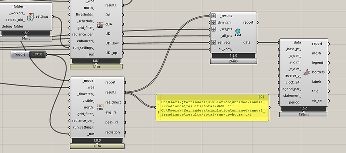

Could it be a version error? I see some components being 1.8.0 and some 1.8.1
Which version did you install? Did you run LB Versioner and update the components on the canvas if needed (use LB Sync Grasshopper File)?
I installed the pollination single click installer some time ago. It was LBT 1.8 version. I tried with other computers and the script runs perfect.

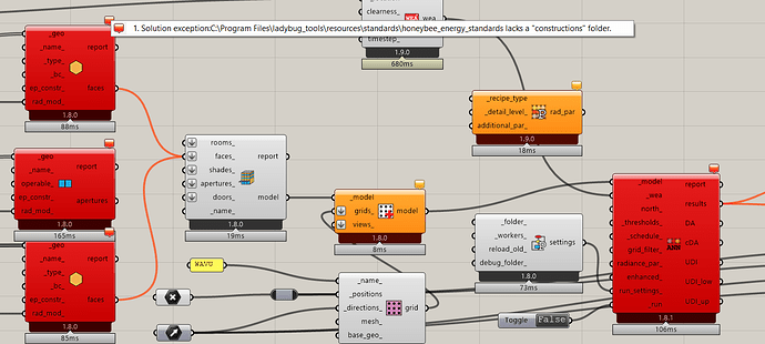

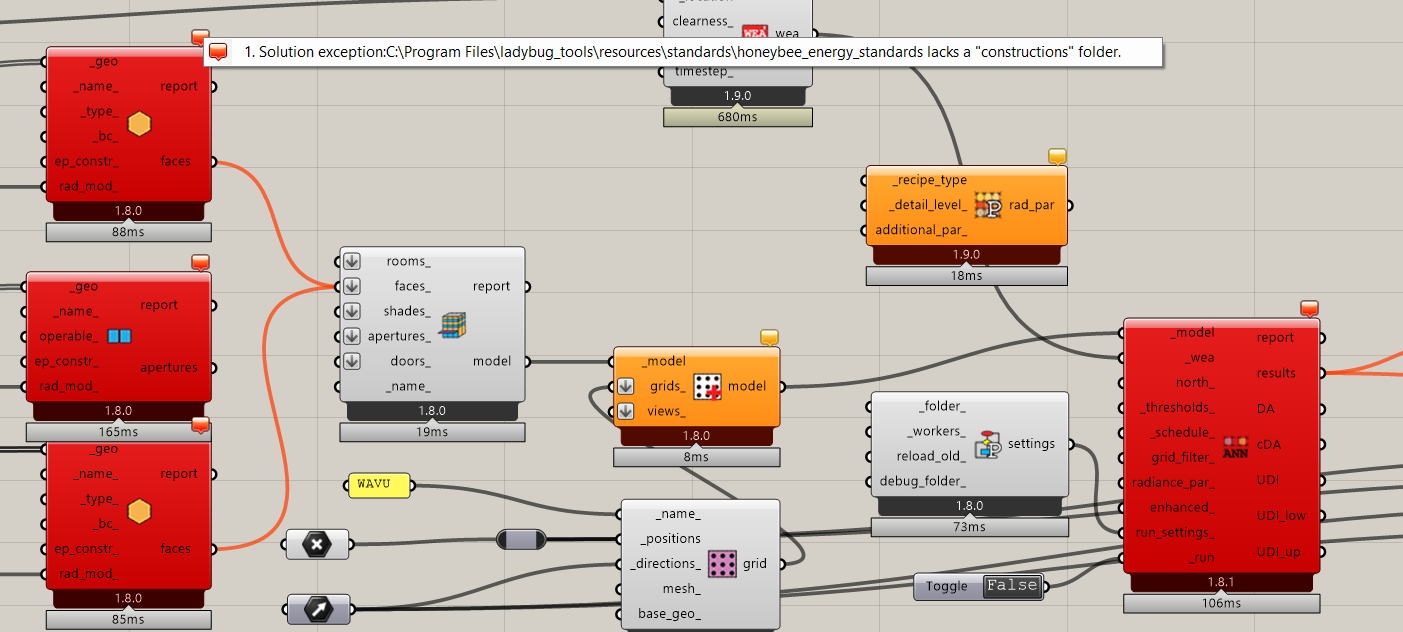

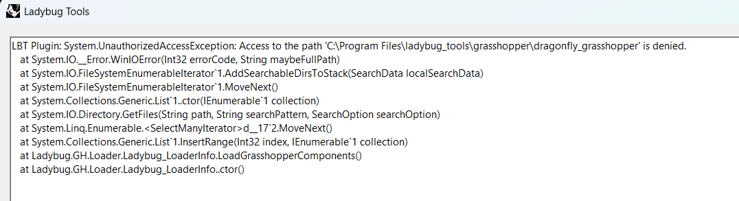

I try also running LB Versioner but a different error pops up. Now no component works. :man_facepalming:
I have updated Ladybug with the grasshopper installer to the newer version. The same problem ocurs. All components work but the annual results to data.
Furthermore, if i open the results folder with another computer it open the results without any issue. So the problem is clearly localized in the annual results to data component, everything else is working just fine (simulation results).
For other annual metrics such as irrandiance it works fine, it only happens with the daylight annual analysis results.
Any idea what could be provoking this error? how can i fix it?

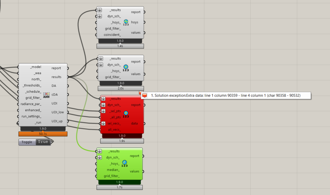

The error:
  1. Solution exception:Extra data: line 1 column 90316 - line 4 column 1 (char 90315 - 90489)
    The report:
    Runtime error (ValueErrorException): Extra data: line 1 column 90316 - line 4 column 1 (char 90315 - 90489)

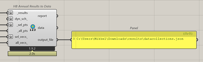

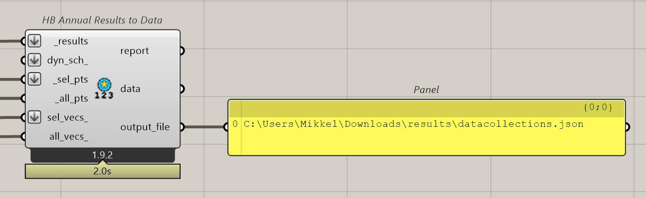

It also works fine for me. There is nothing wrong with the results folder. I am not sure what the issue is yet, but I can see that it fails when trying to read the results as data collections.
I have made a small change to the component that will write the data collections to a JSON file. Can you try to run it and share the output file? If the component still fails please check if it created datacollections.json in your results folder and share the JSON file.
annual_data_output_file.gh (9.4 KB)
Surprisingly that component works.
See datacollections.json file:
datacollections.json (88.2 KB)
