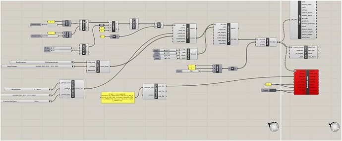

Hi there,
Could you help me figuring out what happens with my script?
It said:
Solution exception: ** Fatal ** Errors occurred on processing input file. Preceding condition(s) cause termination.
I will provide the original model,Any help would be appreciated.
Hi @TSN
I tried to recreate your error by building a simpler version of what you’re doing and noticed that all of your rooms have the same name. I plugged in a series starting at 0, going up by 1, and the same count as the HB Move component. So essentially a series that goes 0, 1, 2… 10.
This now causes all of the rooms that go into the Annaul Loads component to have unique names. This caused the error to go away.
Hope this helps and resolves your problem.
Cheers,
Anthony
Hello @anthony.schneider , As a beginner, this is very helpful for me. Thanks :slight_smile:
