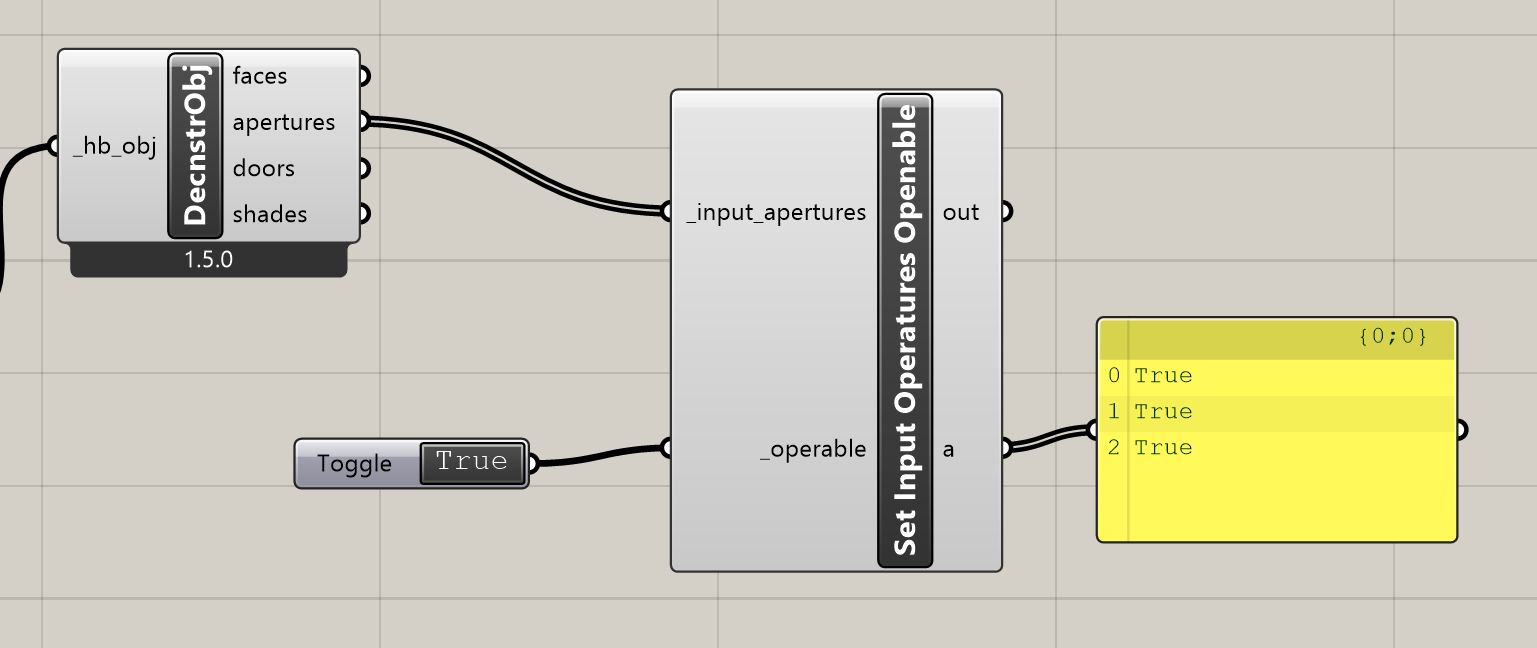

Hi @ffotsing, here’s a simple script that lets you toggle windows operable to on/off (True/False)
LBT_Set_Operable_Windows.gh (25.1 KB)
It took me a little while to work out the code, but this is what’s inside that ghPython component
x = _input_apertures
y = _operable
x.is_operable = y
a = x.is_operable
It seems that the LBT objects are held in Python memory - so if you set the windows as operable here it doesn’t need to be reconnected into the general “stream” of components.
