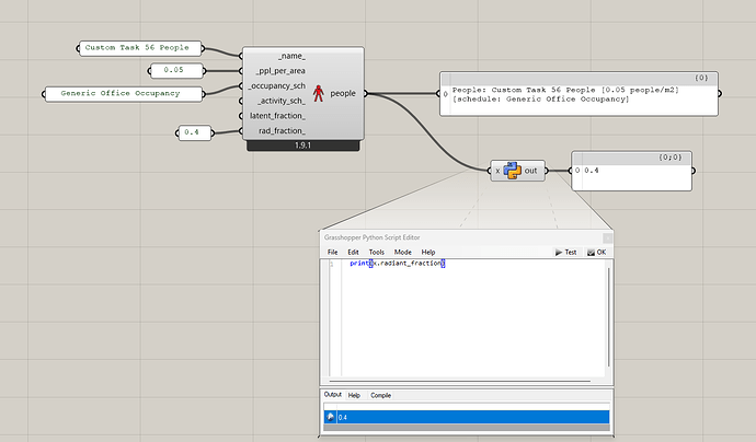

Hi @hamed.sangin ,
It is possible to change the people radiant fraction in Ladybug Tools but we currently did not expose it on a component. You can see that the radiant_fraction exists in the Ladybug Tools SDK object for People. So you can currently specify it with a custom GHPython component but, to save this issue from coming up again, I just exposed it on the HB People component.
I just pushed the change here:
… and you can get the updated component on your end with the LB Versioner now, which looks like this:
new_people_component.gh (8.7 KB)
