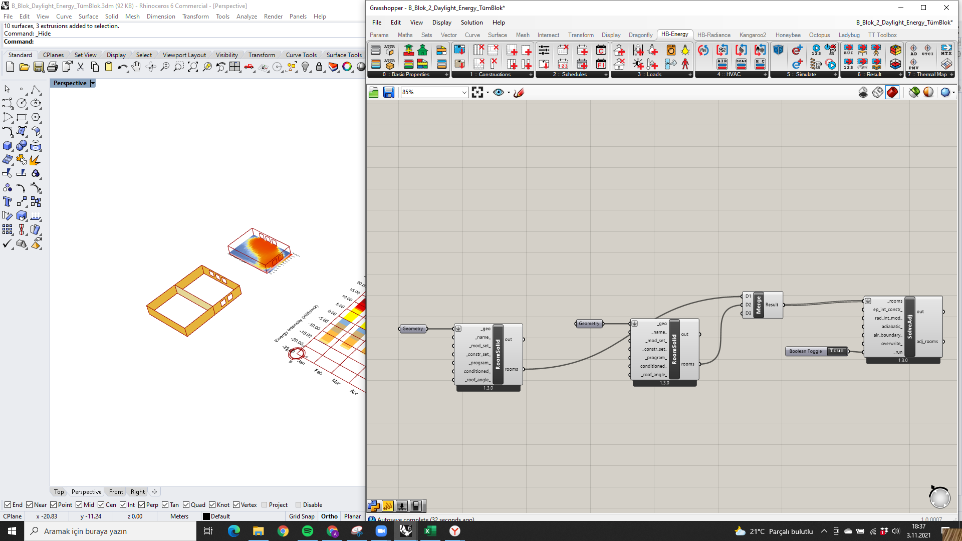

How can I assign different people, lighting, and HVAC schedules for different zones for the energy calculations? I was wondering the image below could be a solution. For each zone, I have defined different rooms, merged them, and then solved adjacency. In this way can I assign different schedules to different zones (rooms)?
In the download file for LBT, there is a sample file in “honeybee_energy” called “full_building_energy_model.gh” that will be a good reference.
Otherwise you have the right idea of applying the space program to each brep then merging to solve adjacency.

Thank you very much! I will definitely visit those example files.
