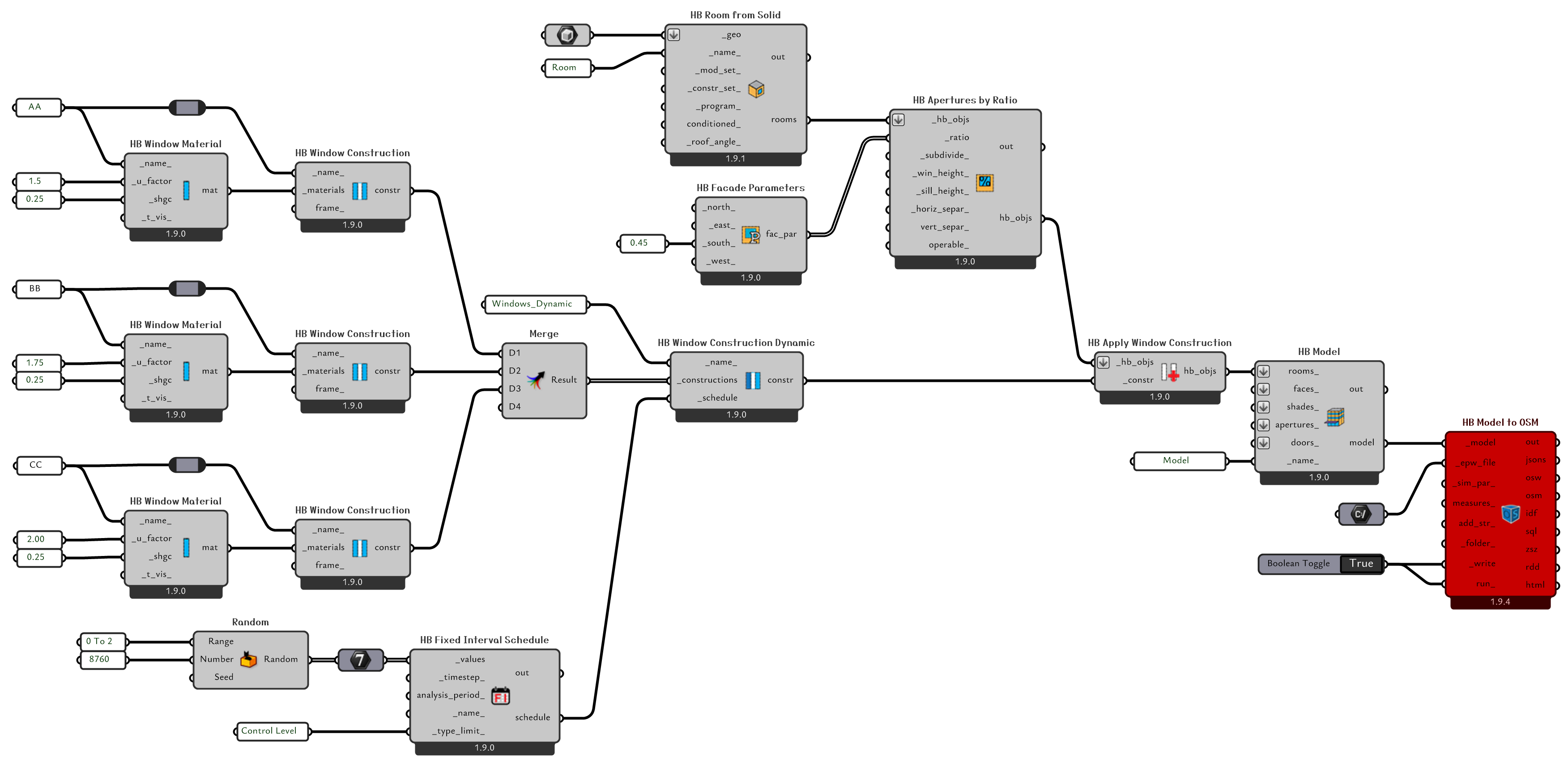

After the Window Construction Dynamic component was updated to version LBT 1.9, it is still unavailable in the latest version as of today. I am certain that this component was able to function normally within the expected range in version LBT 1.8.
I have created a simple case for you to test and attempt to reproduce.
In any case, the program’s feedback is exactly the same as this.

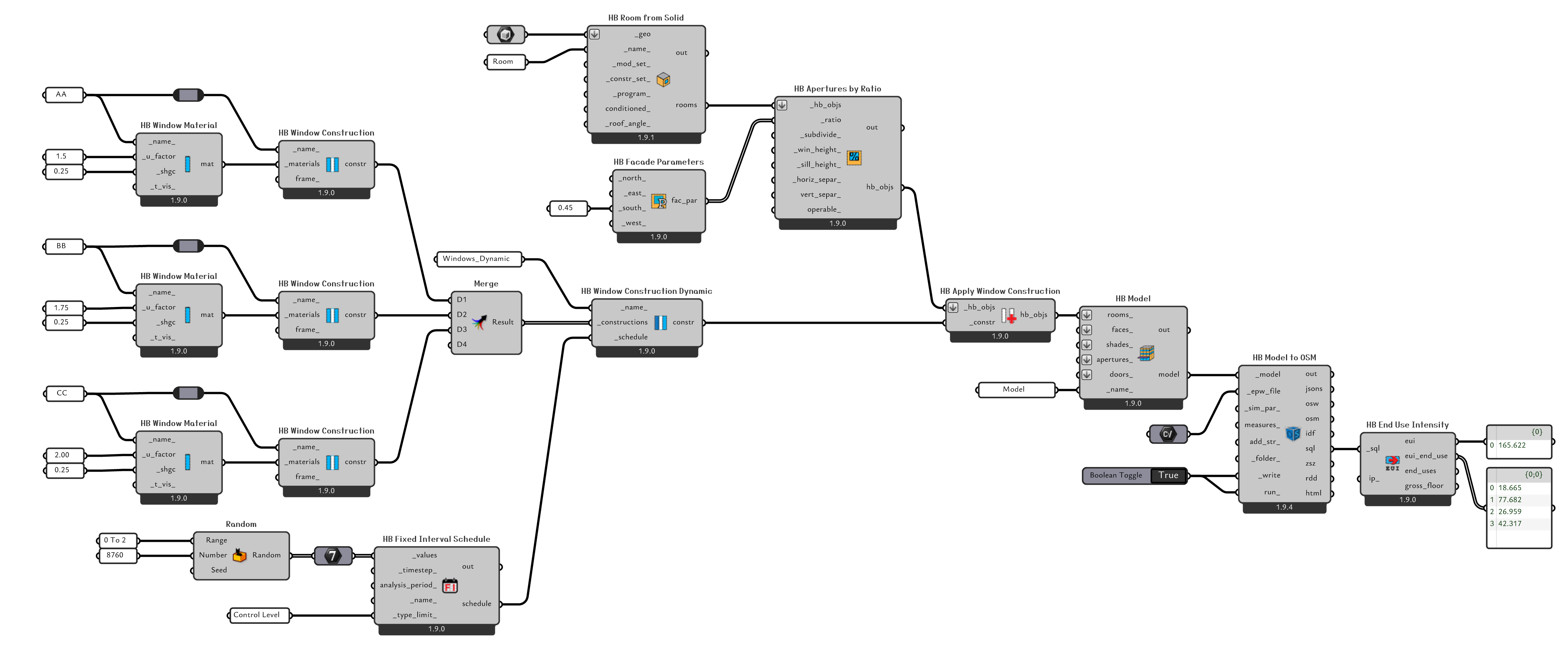

Yes, this is a bug and sorry if I missed seeing earlier posts about it. From what I can tell from my tests, it appears to be an bug that is exclusive to the OpenStudio .NET bindings (used in IronPython) since I can only recreate the bug there and I cannot recreate it with the OpenStudio cPython bindings. This explains why the bug has flown under the radar so far. Also, it truly seems to be a bug in OpenStudio’s .NET bindings that I should report to NREL at some point but I was able to work around it all by changing the code around here:
So this allows you to run dynamic constructions in both IronPython and cPython without issues:
The fix is now available via the LB Versioner. Please let me know if you get the chance to test it.

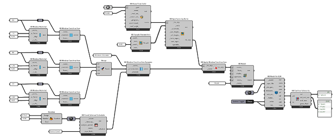

Thank you for taking the time out of your busy schedule to solve this problem.In my test, everything went very smoothly.
