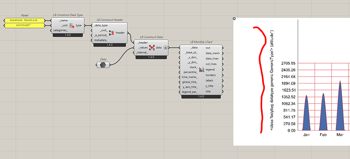

I’m trying to create monthly bar chart from custom data, but unit appear with type strings as image shown below.
Any idea where I’ve done it wrong?

Hey @tutu7931 ,
Good catch. I just pushed a fix to the latest development version for this issue:
You can get the fix with the LB Versioner in an hour and, in the meantime, you can just use the y_axis_title_ input of the Monthly Chart component to override this default title.
