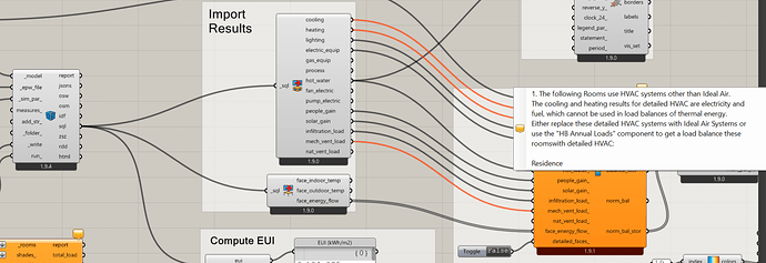

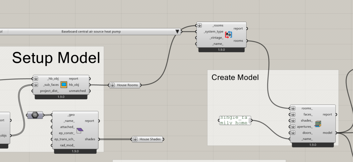

I am new to LadybugTools, I am using the newest version of it, and playing around witht the “Single family energy model”. When I want to add a different HVAC system, exactly “Baseboard centrail air source heat pump” since I want to modell Heat pump with radiator, at the “HB Read Room Energy Result” there is nothing for heating. When I remove it there is heating but with it there is no. My aim is to set up a little bit more complex energy study, comfort too with air source heat pump+ radiator.

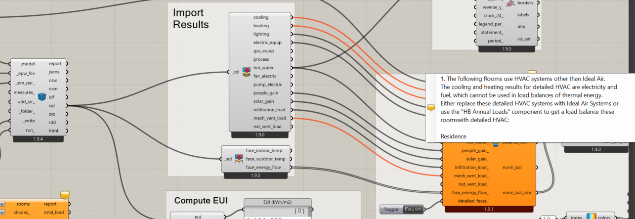

It seems, it does not matter which system I select, the cooling and heating values are always empty (yellow).
Hi @Akos, the second picture, the yellow components message gives you your answer. For load balance, no HVAC other than ideal air can be used
