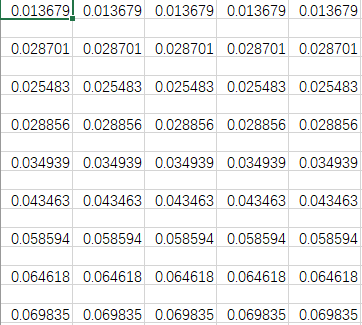

I’m wondering programming in GH ironpython to copy the first column in csv data to other columns. I write some code and it works well in python environment (I use Spyder), but not good in “GH Python Script Editor”, which will create an additional blank row for every data. Just like this:
Here is my code:
