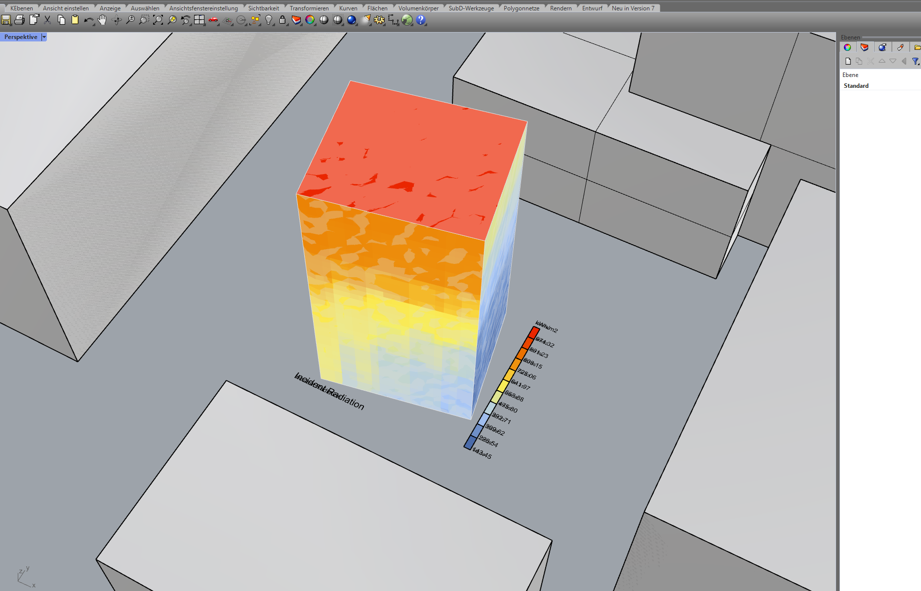

Hi guys, I am starting with ladybug tools and I have already a problem. The texture of the radiation analysis on the geometry is super blurry. I dont no why and I cant find these problem in the internet. I have the latest version of Ladybug tools and Rhino 7. That would be amazing if anyone can help me with that.
Try hiding your input geometry from the rhino scene - the results mesh is coincident with your input geometry and being coincident makes the Rhino view look patchy.

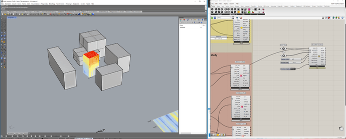

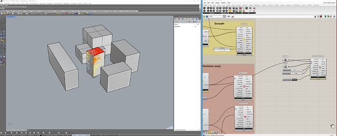

Thank you for your fast reply. Actually now it is way better. But still it looks a bit patchy… In all the tutorials I watch its not like that. Is there any other solution? I thought the offset distance to the surface is not enough but it does not change at all.
Hi @Dan94, that’s another coincident issue - in you grasshopper script preview is turned on for all components. You can either turn off preview on all components except the output, or turn on the green/white toggle in the top right corner of the grasshopper canvas so you only preview selected components.
Hi @charlie.brooker sorry for the late reply! Thanks a lot for your support. The information was really helpful for me. I see that I have to play a bit with the visibility of the geomerty and the selection preview.
