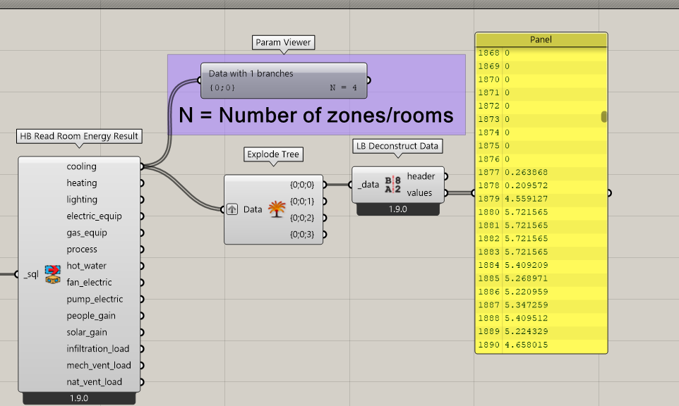

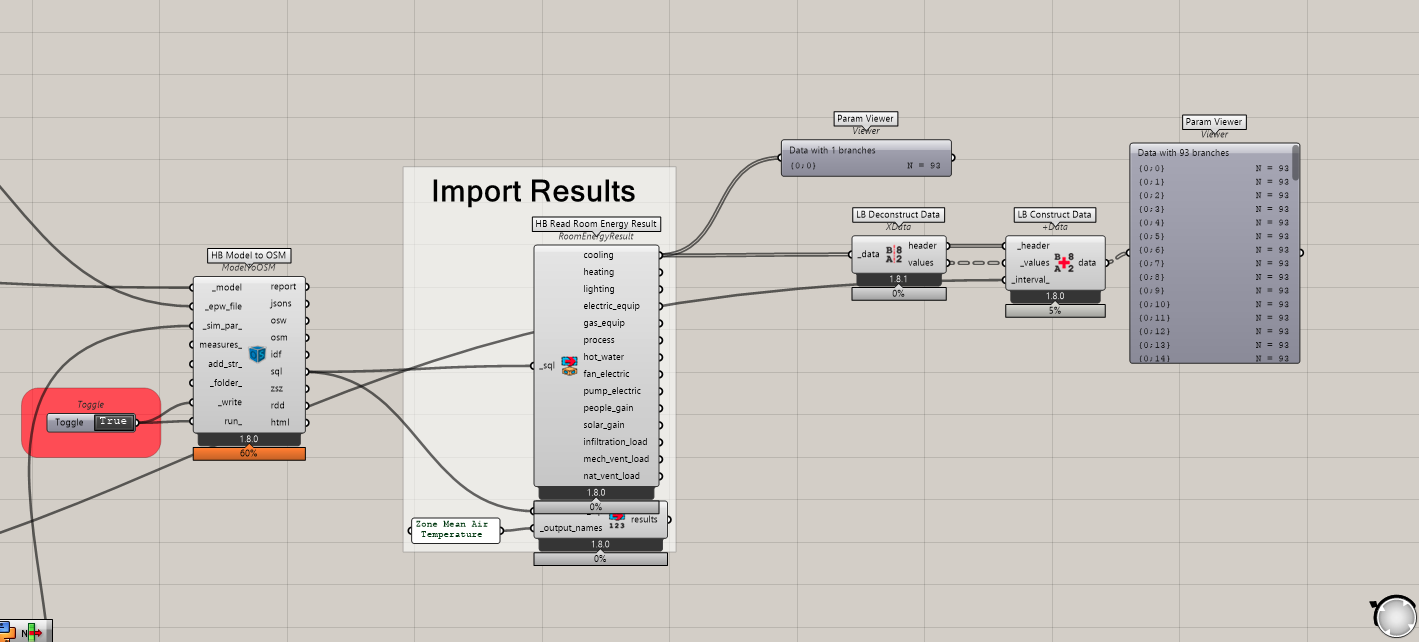

when I extract cooling or heating results from a multi-zone simulation (for example, the Full Building Energy Model sample), the output for a branch contains 93 data points. However, when I pass this dataset through LB Deconstruct Data and then rebuild it with LB Construct Data, the number of data points changes.
This issue only happens with energy-related outputs. It seems to be a bug …

@Mohammad.hakim.a I think this may just be data handling related
does this solve the issue you are having?

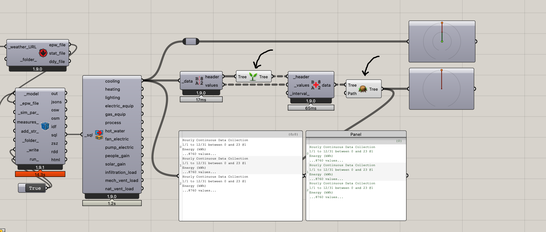

Hi @Mohammad.hakim.a
You can graft the headers, then flatten the output to get back to the original data-shape.
best,
@edpmay
Example File:
