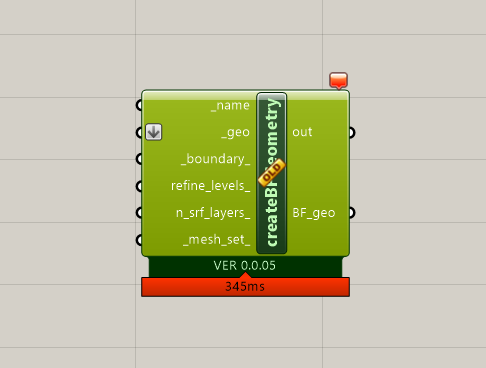

Hi there, I am having the same issue that I can’t seem to fix.
Even when installing butterfly there is a label on the node saying ‘old’.
When I look at V 0.0.2 it shows that it’s a BUG fix and I can’t find install for this version:

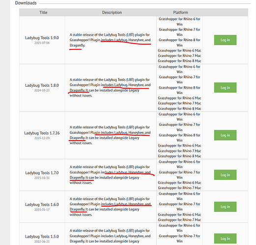

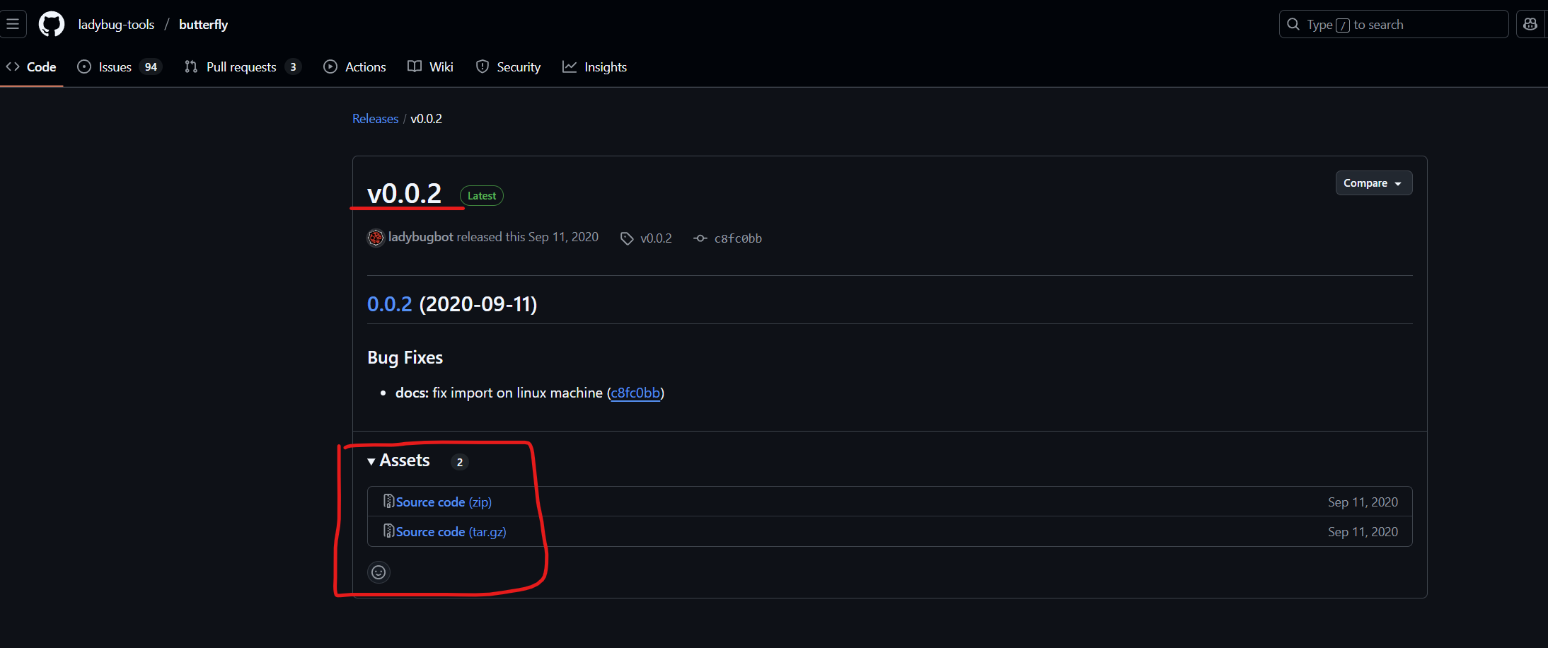

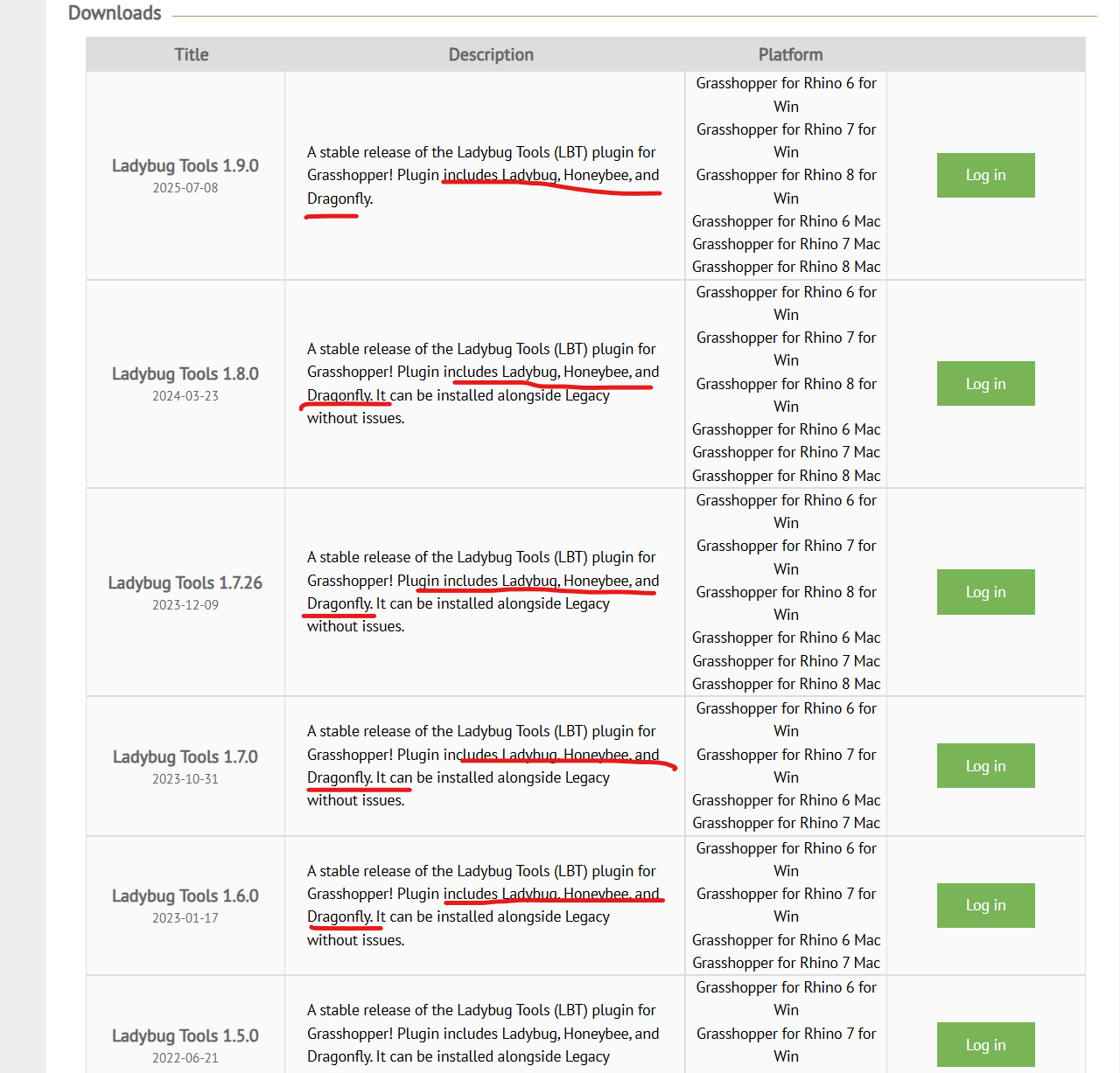

Hi everyone,
I’m experiencing the same issue — I can’t find the installer (.exe) or (.gh) file for the new version of Butterfly (v0.0.2).
on @mostapha’s GitHub page, there’s only a ZIP file of the source code, and I’m unsure how to use it. I also couldn’t find any mention of Butterfly in the latest Ladybug Tools installer — it includes Honeybee, Ladybug, and Dragonfly, but not Butterfly.
The only available version of Butterfly for Grasshopper seems to be the older one.
Does anyone have suggestions or guidance on how to install the new version?
Thanks in advance!

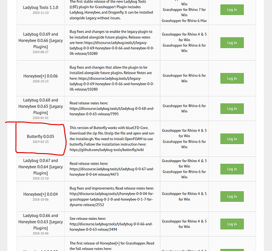

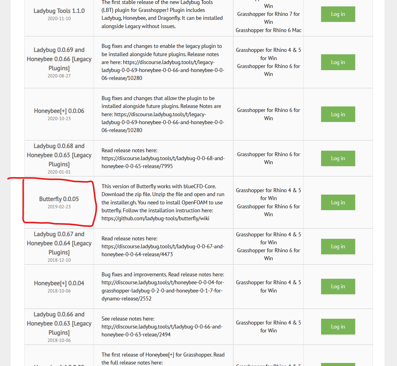

hi, estoy en las mismas pero dice que hay que descargar la version de butterfly 0.0.05 y luego los Blue CFD supongo que del mismo año, y ponerlos en una ruta qeu no tenga espacios, pero aun no lo logro
