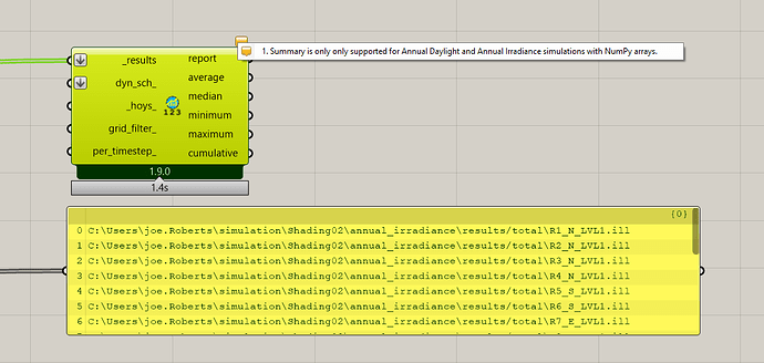

Hi again @mikkel,
I just had time to test the new component out but I get this error
When I tried using it with the existing results (i.e. reloading) I just got Null values out, so I tried re-running completely and now I get this error.
I’m able to use the other post-processing components without any issues.
Any suggestions?
Thanks
Hi @jroberts,
I put in that error because the annual irradiance recipe in the LBT plugin is not using NumPy arrays yet. You can use the irradiance recipe in the Pollination Grasshopper plugin and run the studies locally (the recipe on Pollination is simply called ´irradiance´) to get around this issue.
The reason why I didn’t just update the recipe in the LBT plugin is because I have to make some changes to the information in the results folder before the component will pick up the correct unit for the data collections – so if you use the recipe through the Pollination plugin you will have to live with the fact that the unit in the data collections is illuminace / lux until I have changed the results folder.

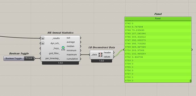

Hi @mikkel
i hope you are doing well
when using HB Annual Statistics and the toggle for pre-timestep is on, a data collection will be produced annually. i think it needs a selected testpoint already. but there is no any selection in this component. form the logic of values, i think this is an average for all test points. is it right?
Ali Goharian
Hi @Aliarch,
Yes, it is the average for all test points in the grid. The component works similar to HB Annual Average Values – you just have a new option per_timestep_ which will give you the hourly average for each grid rather than the annual average for each sensor point.
The component does not support using only a subset of the sensors.
