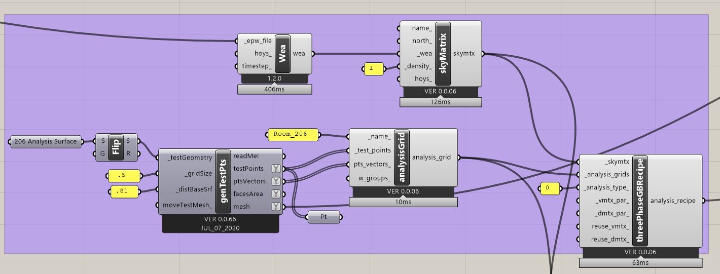

I am trying to simulate annual hourly illuminance, radiation and luminance values using the 3-Phase method in Honeybee[+]. My script is working fine for the illuminance calculation, but the same script gives me an error while I am trying to calculate the luminance and radiation values for the same grid points.
When I am giving input “0” in analysis type, I am getting the proper results for the illuminance values.
But, as soon as I am changing the input value to “1” or “2” for radiation and luminance analysis on the same grid, I am receiving the following error.
"1. Solution exception:AssertionError"
Kindly suggest, how to run radiation and luminance analysis using the 3-phase method?
I tried using the DCoefficent Grid-based recipe as well and it is working fine for me but since I am using window groups and BSDF materials, I am not sure that I can use the DCoefficent method or not.
