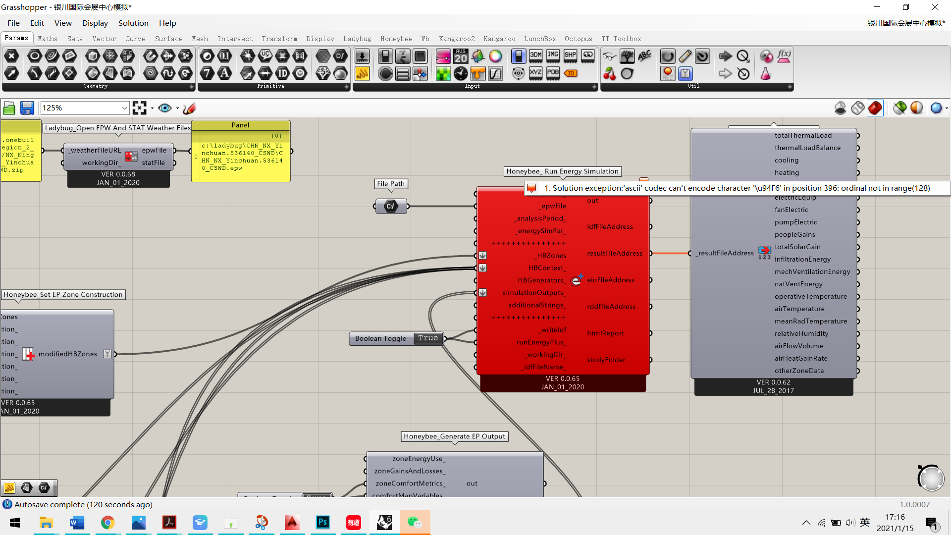

It sound to me, that you have the character “银” somewhere (“silver”?), possibly in a file path or a name (zone, material, construction, etc.)?
Don’t use special characters for the simulation, EnergyPlus and other software are really sensitive to non-ASCII characters. In other words, limit yourself to the English alphabet, use these characters for the visualization legends only.

I realised you have another screenshot as well, this could be the problem:
But there’s still a problem with the display but the simulation has data output
