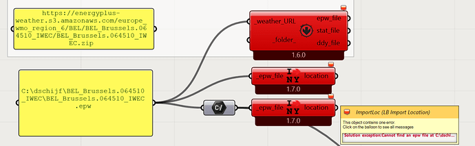

I’m trying to use a epw file that is stored on my computer. But for some reason, I keep getting the message that it cannot find a epw file at the specified location. I’ve tried moving it to a different folder, I’ve tried moving it to my desktop, I’ve tried it with different epw-files, nothing works. The online weather file works without a problem, but when I want to use one on my hard drive, I can’t use it. Has anyone else had this problem?
The reason why you got the error message is because you chose the wrong component to read the EPW file. Try to use ’ LB Import EPW ’ instead!
/Bernard
I’ve now discovered the issue. The panel was a multiline panel. Simply getting a new panel and copying the link there resolved the issue.
