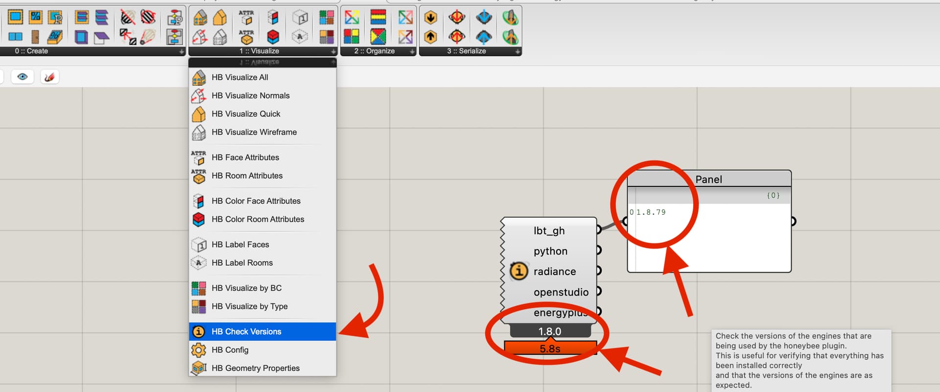

I think there’s a 1.8.1? But no matter how I press the versioner my components are stuck at 1.8.0. Does this affect capabilities because am having issues with some of my codes…

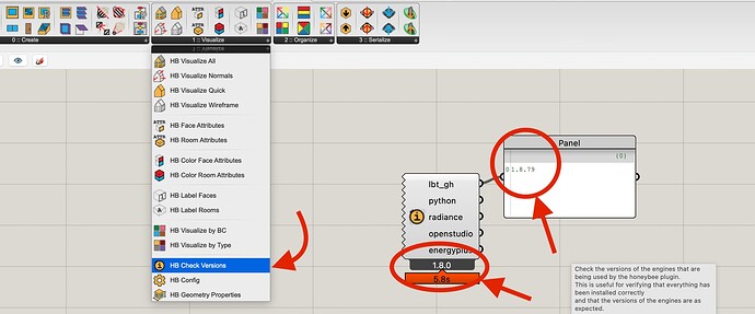

Are you sure? The components will always show 1.8, but you may be up to date on the libraries behind the scenes. Try using the HB Check Versions ?
@edpmay
Oh this fixed it.
I thought it wasn’t updating because I only saw 1.8.0 LOL
