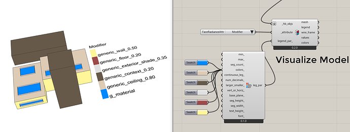

You can also get pretty close to this customization using the Legend Parameters with the “HB Color Face Attributes”:
Or, if you like a fully customizable solution in like legacy, you can use the “HB Faces by Type” component with the other visualization components and native Grasshopper Preview components like so:
FYI, I just pushed an update to the “Organize” components to get them to accept a Model in addition to Rooms. So I recommend updating before trying the last solution.
Also, re-reading your original question about transparency: Unfortunately, Rhino does not support transparent meshes and meshes are what is being used in the “HB Visualize by Type” and “HB Color Face Attributes” components.
The last solution I posted using the Grasshopper “Custom Preview” components can accept transparency, though. So that’s the solution that I would recommend for your case.
