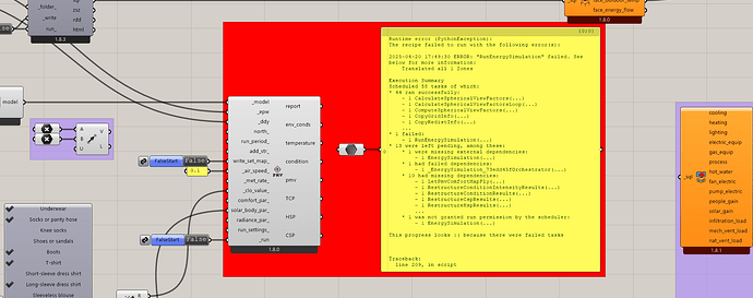

I am using the “hb pmv comfort map,” and I do not know why I am getting this error. I reviewed previous threads to find a solution, but I couldn’t. I would appreciate it if anyone could help me with this.
I will add a screenshot with the error in a red group.

Thank you for your reply. Sure, I believe so because it was a tricky situation and I will share a screenshot so it can help if anyone else got themselves in similar situation.
All right, So as I mentioned above, I could find the problem in the first part of my GH script. (tbh, it somehow seems weird but it worked. )
  1. The very first issue was related to the first box. I moved the base curve and lofted them, then moved them in the Z direction with the series component. In the end, I used ‘cap holes’ to create closed breps.
    But instead of that, I changed the whole process the way I share below :point_down: :point_down: :point_down:
    I created a box (closed brep) and then moved the whole box in the Z direction with the series component. It worked :smiley:
  2. The second part was to add them all to a ‘brep’ component and then connect it to the ‘hb intersect solid’. (Without ‘brep’ I recieved errors from ‘hb intersect solid’)
This is how it all worked. I don’t know, but somehow, the way I changed the whole box-generating process looks weird to me.
I hope it helps everyone who faces the same issue in the future. :v: :v: :v:
