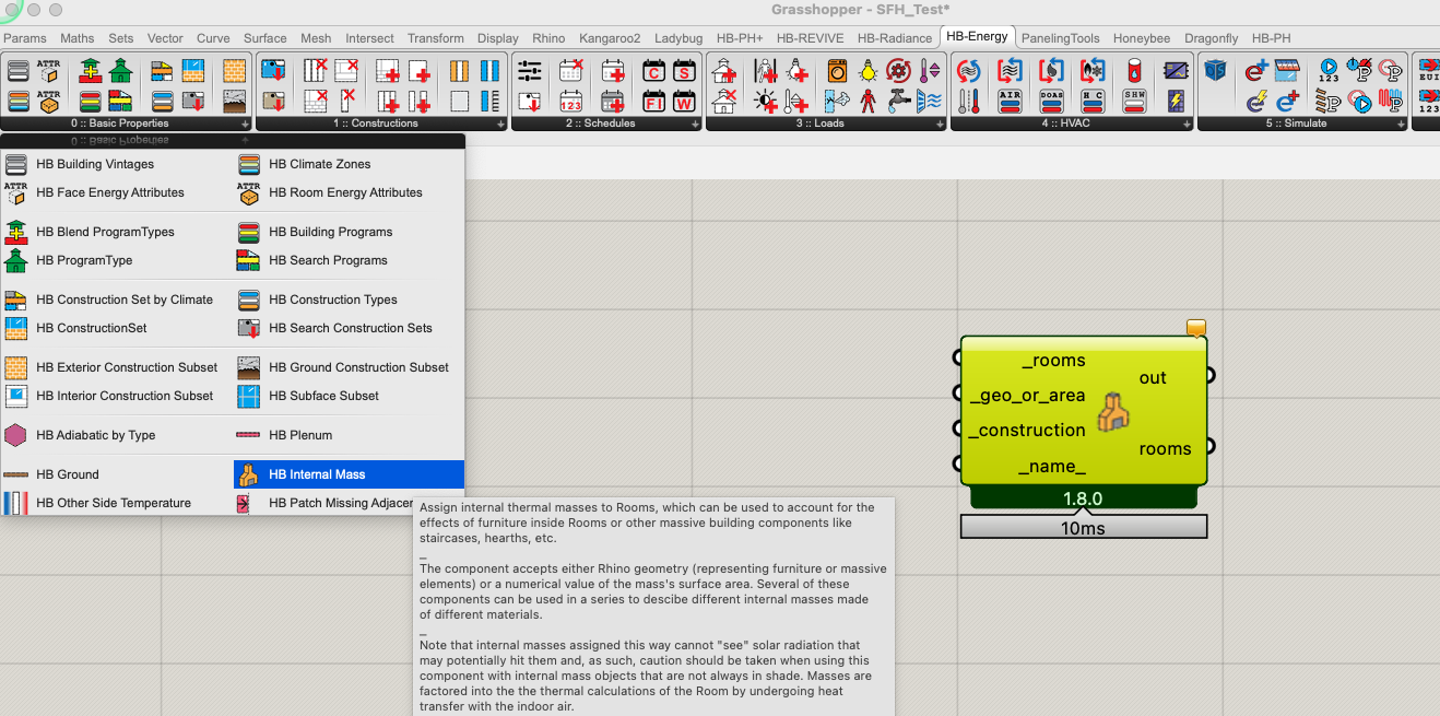

You could use the “HB Internal Mass”, if all you are after is the effect of the surface’s heat storage?
best,
@edpmay

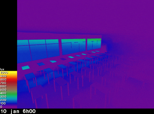

But for daylight you can use multiple interior surfaces as context. I recently created a classroom with desks to find out the amount of lux above it.
animated_video (2)
Not bad, can do ! Thanks for the tip
