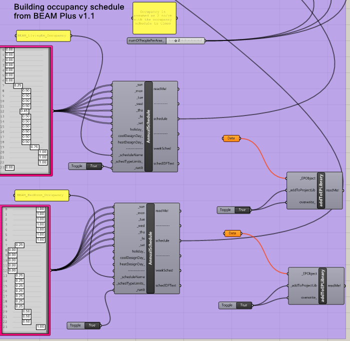

n my simulation, I didn’t use the schedule from honeybee but I would like to create my own schedule by using “Honeybee annual schedule” as shown below:
I will suggest connecting directly the output “schedule” instead of loading from the library.
I kind of remember from old discussions that the schedules are not well registered in the library using the HB_addToEPLibrary. The fact is that they are not loaded right.
I don’t believe my suggestion is going to mess the file (more than it is already), and i believe it will work.
This is the method I tried before to connect the HB_Annual Schedule immediately to HB_SetEPZoneSchedules. However, there is a warning message “cannot find ….in Honeybee schedule library” as shown below. And the whole simulation does not work.
In view of this warning, I just try the method to HB_addToEPLibrary.
