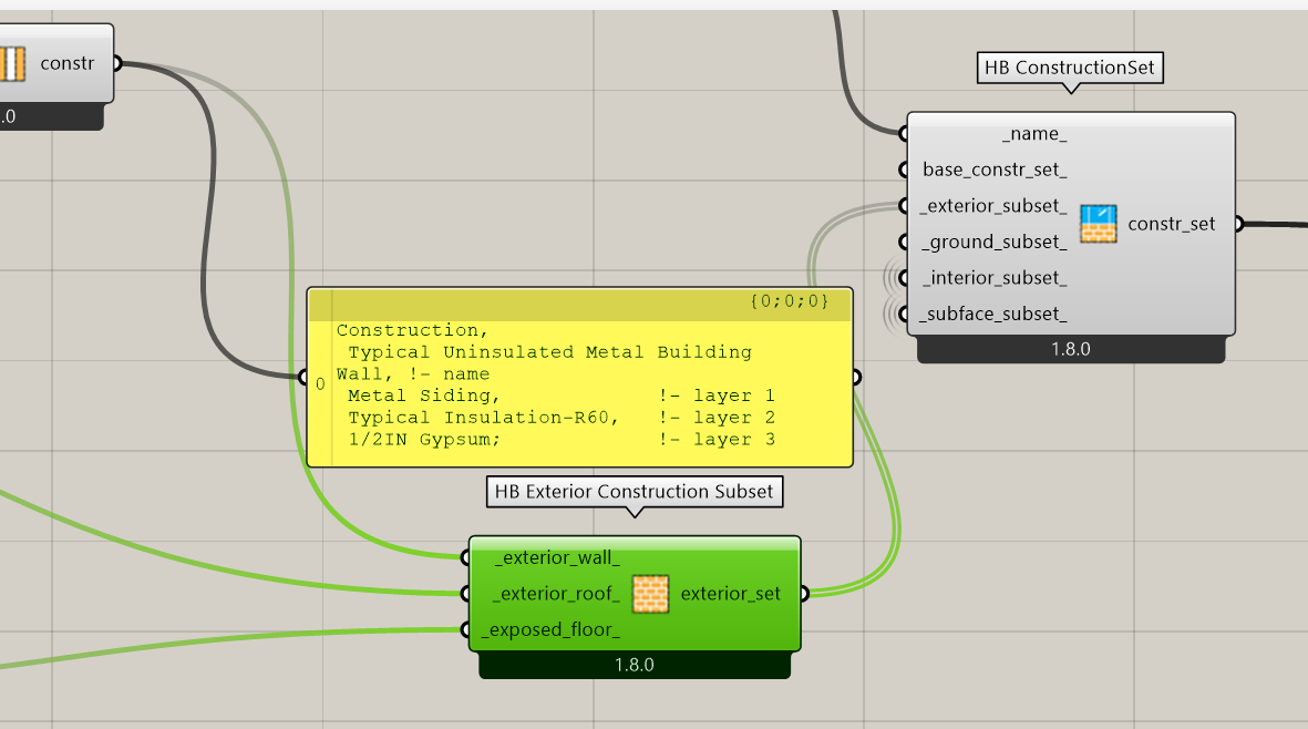

Hi all, I am trying to take a preexisting .idf file and rebuild it to be parametric in Grasshopper. Essentially all I am reusing is the geometry. Because of this, I have created a new Construction Set and it will not apply. The entire set is showing up in the .idf file defined, but everything is being overridden by the generic set. I found this when I switched the roof insulation from R-0 to R-60 and seeing no change. Obviously something is wrong. I have tried everything I can think of. If anyone knows why this is happening or has a solution I would greatly appreciate it!
Construction Set Defined: Edit: The R-60 was applied for trouble shooting.

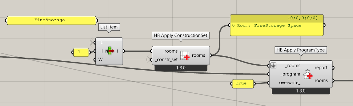

Construction Set Applied:

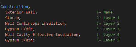

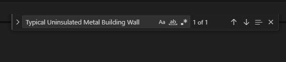

Construction Defined in .idf but not applied to anything:
Instead fully replaced with “Exterior Wall”:
Same goes for all other custom constructions.
