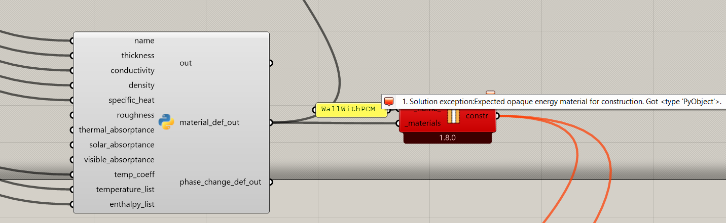

I’m trying to create a custom component that mimics the functionality of HB Opaque Material, with the goal of using it as input to the HB Opaque Construction component.
I’ve written a Grasshopper Python component to define a material, and while the script runs without errors, I’m encountering a problem when I try to connect its output to the HB Opaque Construction component. The error I get is:
1. Solution exception:Expected opaque energy material for construction. Got <type 'PyObject'>.
You can see the error in the attached image.

Hey @hamed.sangin ,
Your code looks correct there and I think I know what is going on. Are you in Rhino 8 and are you using the Python 3 Grasshopper component? If so, that is not compatible with all of the LBT-Grasshopper components because they use GHPython (a flavor of IronPython 2) instead of cPython 3.
To make a component that works with the LBT-Grasshopper components, double-click a blank part of the Grasshopper canvas and type #GHPython to bring up a GHPython component that can work with any LBT-Grasshopper component. Then just edit the GHPython component inputs/outputs and copy/paste your code in there. Then, it all should work.
dear @Chris
Thanks for your help — that was exactly the issue!
My component is now working.
