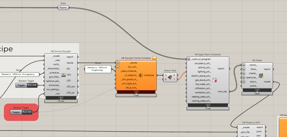

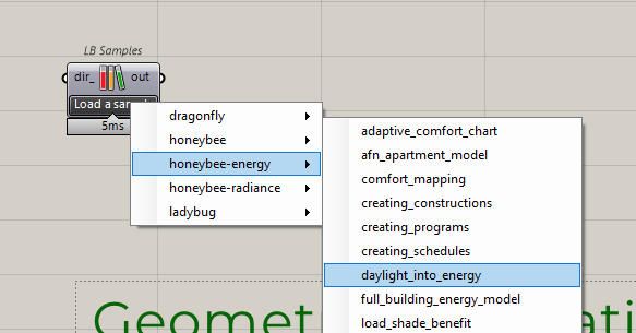

You can do this using the LBT plugins. You don’t need to use the legacy components. See the daylight_into_energy sample file.
I tried to used that script however it does not support additional luminaires as inputs?
