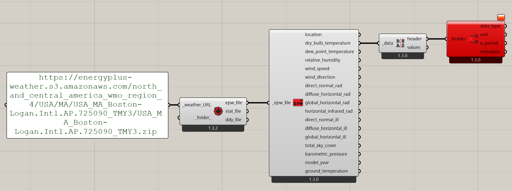

Deconstruct header failing
Just updated with the Versioner and i’ve found that the DeconstructHeader component is failing with the following error:
Runtime error (TypeErrorException): sequence item 1: expected string, float found
Traceback:
  line 48, in script
Just before the update it used to work.
Will appreciate if you can check this.
Thanks,
In the meantime i solved it forcing the val to be string like this (line 48):
metadata = [': '.join([key, str(val)]) for key, val in _header.metadata.items()]
Instead of the original:
metadata = [': '.join([key, val]) for key, val in _header.metadata.items()]
