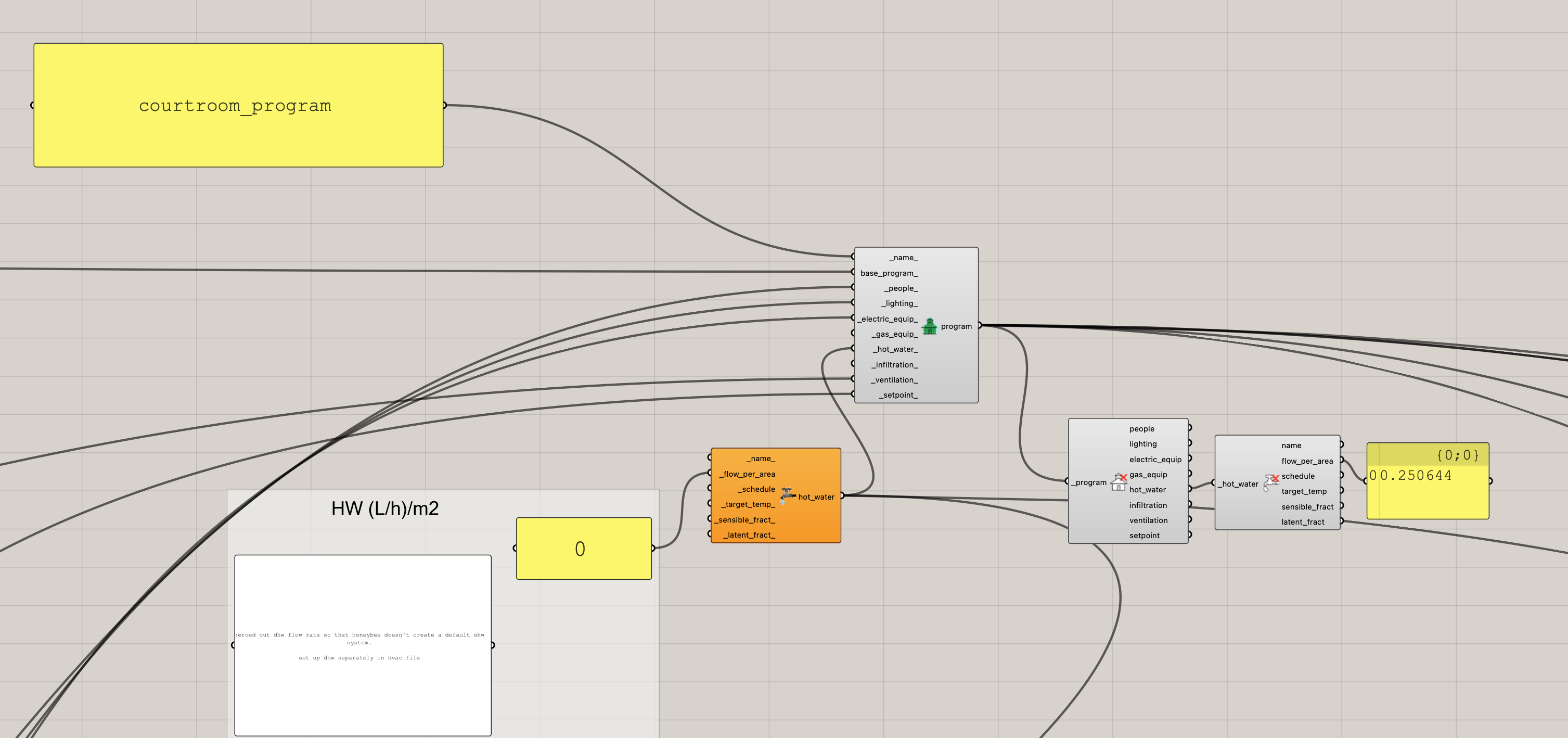

Hi All, I’m having some unexpected behavior trying to zero out DHW and get rid of the default domestic hot water system
In the screenshot you can see I set up a DHW component with a zeroed out input as suggested. This does create a “null” hot water system. However on the right you see that the resulting new program still has a domestic hot water load.
I have traced the issue to the “base program” feature - I am using a default Large Office template as base and the DHW component from the template seems to be sneaking through

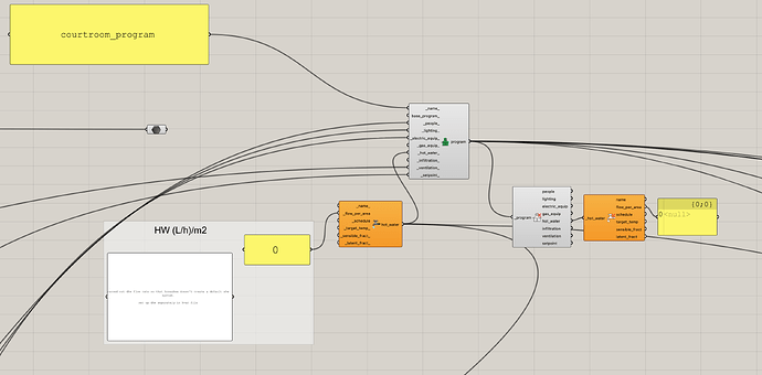

In the example below I disconnect the base program and everything works as expected:
To resolve this I am using the “Apply Load” component downstream in the script to zero out DHW load but it would be nice to not worry about this issue
