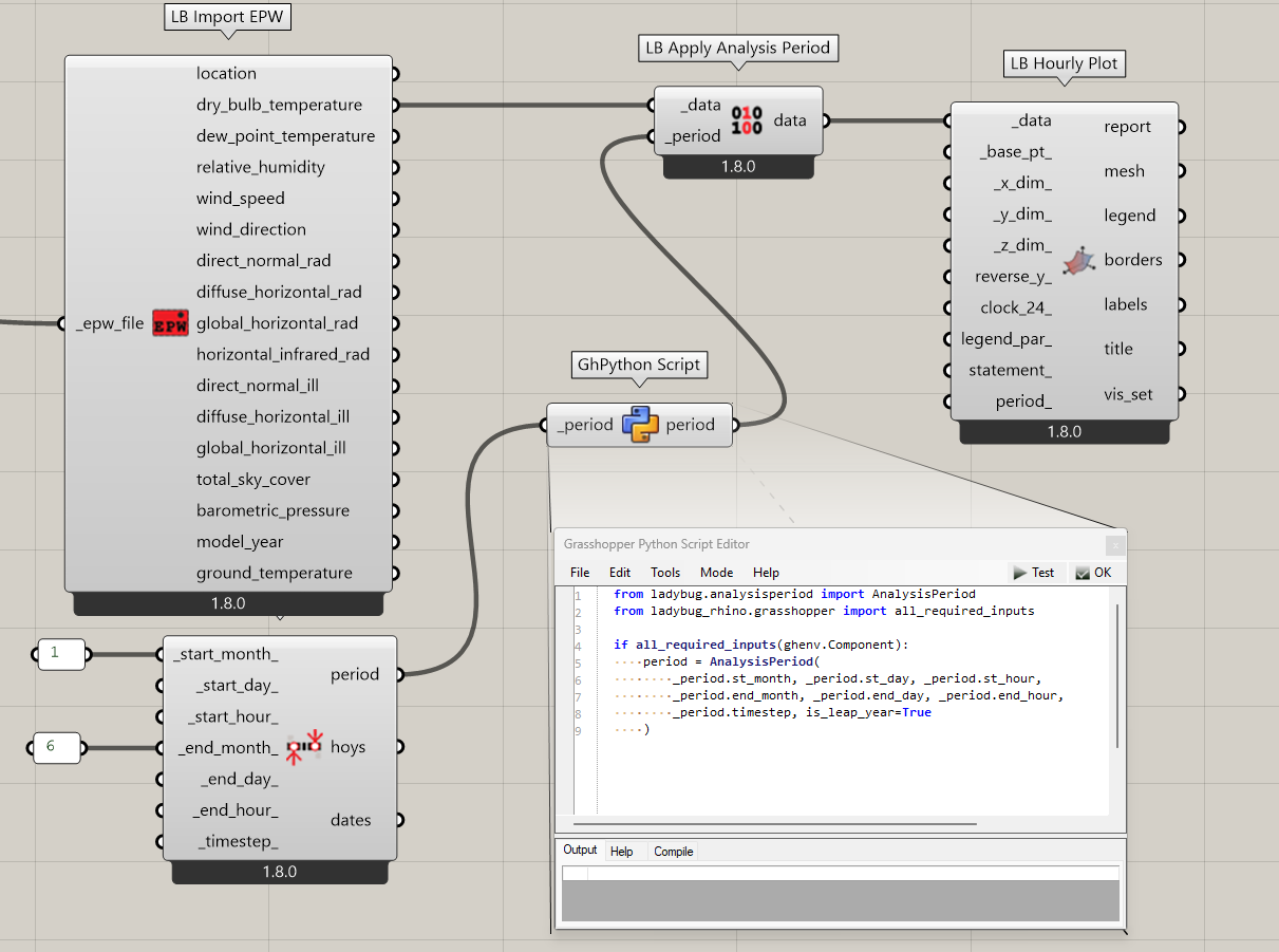

Since I have not heard from anyone yet about the leap year being a consistent pain point, I’m thinking to address this topic by just posting an example GHPython component that takes an analysis period as input and spits out one that is a leap year. Rather than making a change to the official component.
I’ll try to do this tomorrow unless I hear otherwise that it would be really appreciated to make the official change.
Here is a sample file with a little GHPython component in it, which converts an input AnalysisPeriod over to being a leap year:
convert_analysis_period_to_leap_year.gh (21.2 KB)
… and here is a sample leap year EPW if anyone wants to test it:
Sample_Leap_Year.zip (486.4 KB)
This is the code inside the GHPython component if anyone is just looking to copy/paste it:
from ladybug.analysisperiod import AnalysisPeriod
from ladybug_rhino.grasshopper import all_required_inputs
if all_required_inputs(ghenv.Component):
    period = AnalysisPeriod(
        _period.st_month, _period.st_day, _period.st_hour,
        _period.end_month, _period.end_day, _period.end_hour,
        _period.timestep, is_leap_year=True
