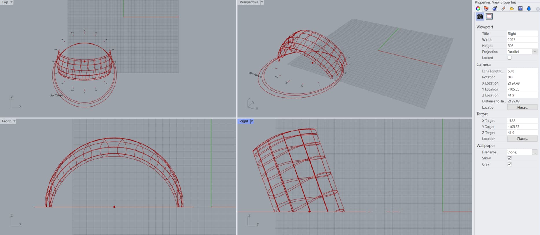

I am doing some tutorial exercises using Ladybug and Honeybee (version 1.5.0). I came across the issue that when moving Sunpath away from Rhino origin (0, 0), the display of the curves start behaving awkward.

Yes, something is definitely happening with the component. @jorgeallen .
At first i was thinking that it happens only when moving the base point in the Y axis, but after changing the zoom view also the X is behaving weird.

Thank you, @AbrahamYezioro. Sometimes it seems that only in the Y-axis is behaving strange. But as you move the sun path around in the X-axis is doing the same.
I’ve found that the issue is happening also with the WindRose component.
The compass lines are those that are displayed weirdly.
