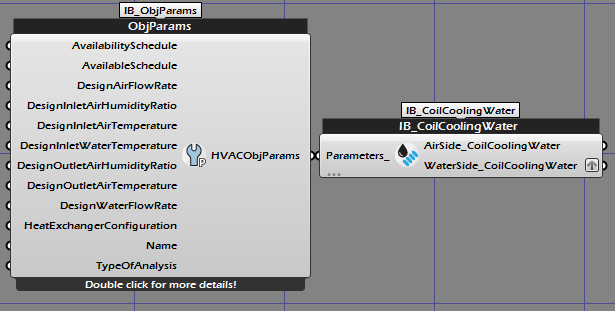

@mrbro the error I’m not sure why but if you want to specify values for your HVAC system that are not in the honeybee HVAC components, but stay within the ecosystem you’ll want to try ironbug.
There are plenty of templates in this component to get started:
Ironbug_template_compo_v2
hopefully that is helpful
