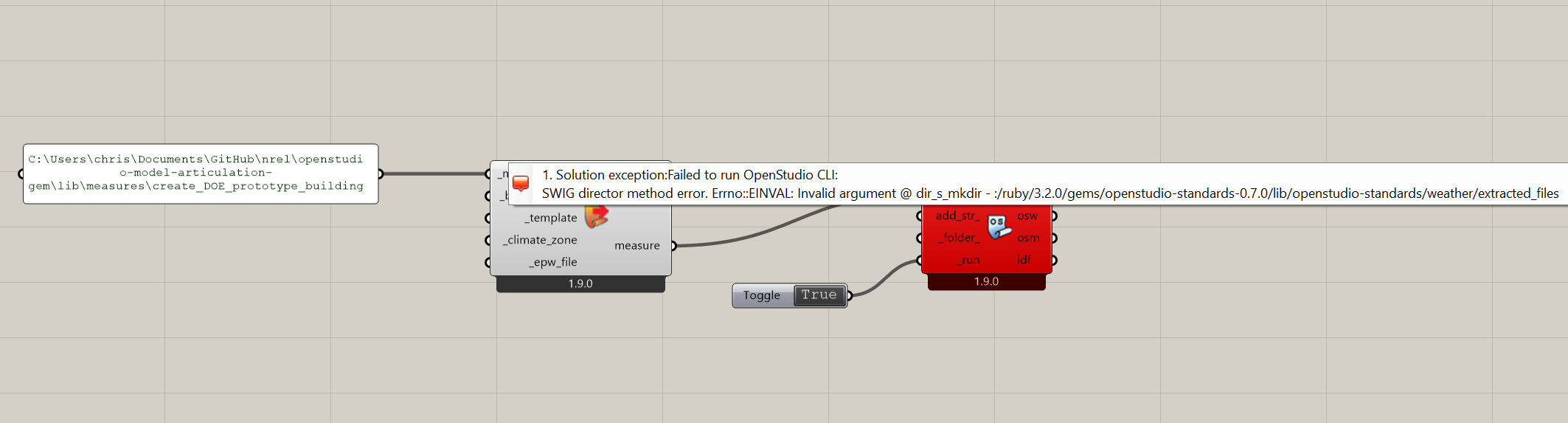

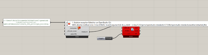

I can recreate it on my end:

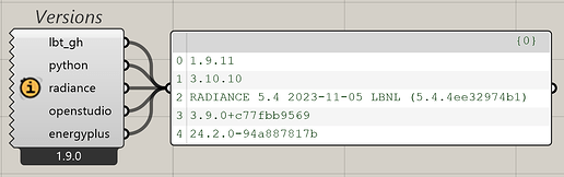

Looking at the issue on the NREL GitHub, it seems like all of this was fixed in OpenStudio 3.10. The latest stable release of Ladybug Tools (v 1.9.0) and the current development version of Ladybug Tools use OpenStudio 3.9.
I had plans for updating the development version of LBT to officially use OpenStudio 3.10 in the next couple of weeks, which should officially address this issue. Do you think you might be able to wait until that point?

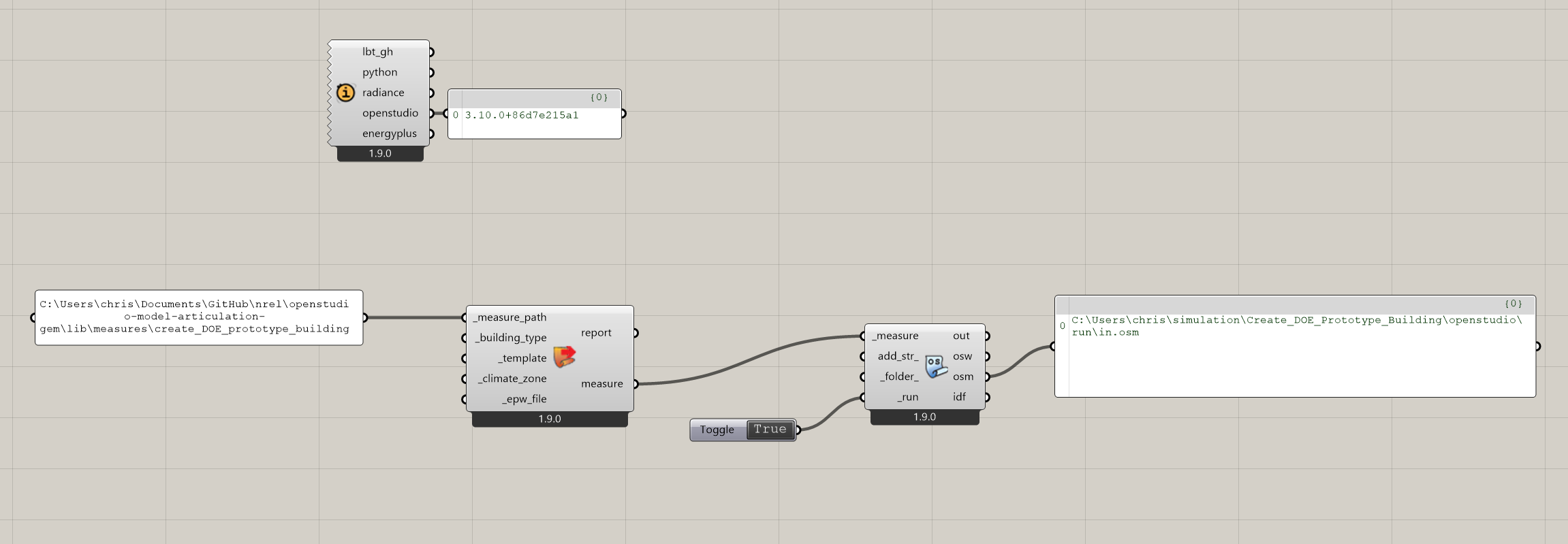

This will force Ladybug Tools to use OpenStuido version 3.10 the next time that it is opened. Granted, it is possible that you might encounter a bug related to me not running all tests with 3.10 yet but, from what I understand, the difference between 3.9 and 3.10 in terms of breaking changes is pretty minimal. From my quick test now, things seem to be working fine with 3.10. And it allows me to run the measure successfully:
