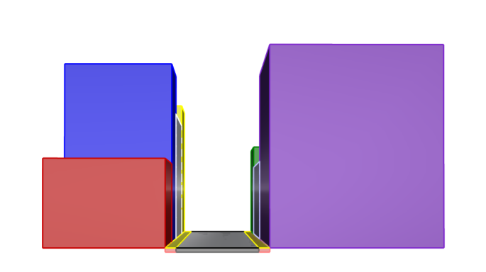

I am using Honeybee with EnergyPlus to simulate the exterior surface temperatures of buildings within an urban canyon. Does Honeybee account for longwave radiation (LWR) exchange between the target building and surrounding building facades when calculating Surface Outside Face Temperature if all the buildings are created as rooms while modeling?
