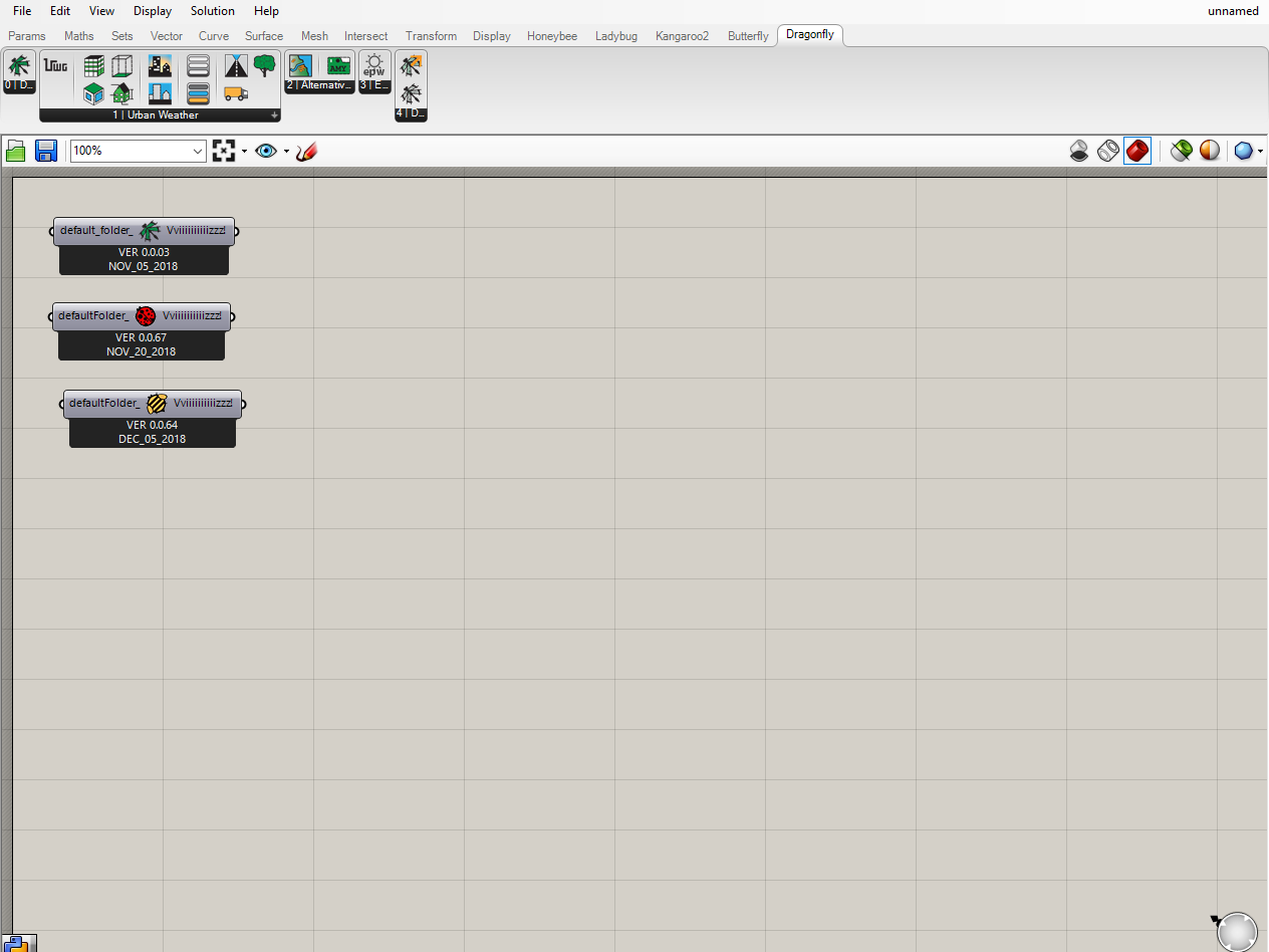

Hello everyone. @AntonelloDiNunzio i tried to install the new Envimet component but i came through this error.Can you please suggest me how to proceed.?
These are some screenshots

Thanx for the reply @AntonelloDiNunzio. I replaced the file i got a new sdk error - i am attaching the file. I am guessing it is only asking for exact sdk version.
