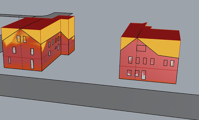

I’m testing the new DF apply roof option,
I’m noticing 2 errors,
- it doesn’t get the roof geometry for all the buildings, it only gets for some of them,
for this building it gets the geometry,
but for this one it doesn’t
- if i add multiple buildings it doesn’t get the roofs properly for the first building also,
Here’s how it is,
if these are the 2 buildings,
the first one is able to get the roof geometry correctly,
However,
if i connect both the buildings it even the first is losing its roof geometry,

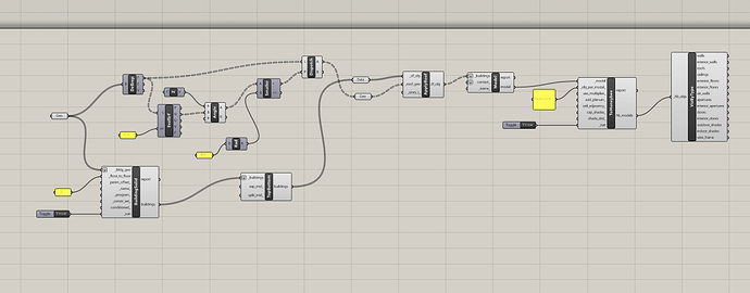

this is the grasshopper tools i’m using,
please let me know if there is any solution for this
