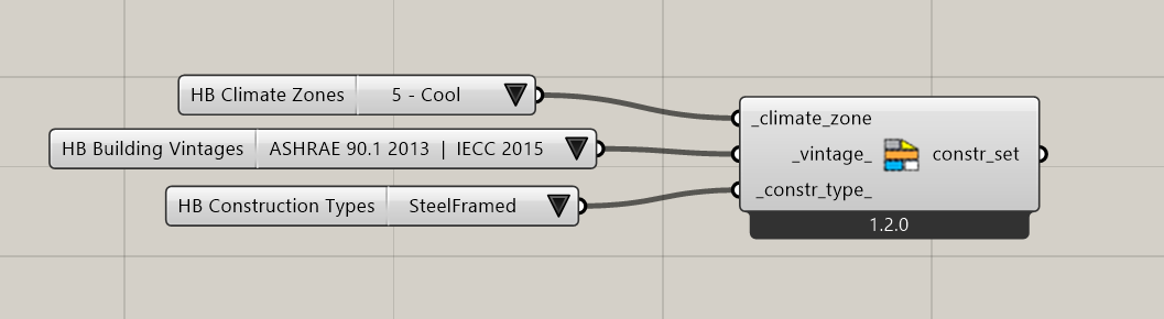

I model historical buildings which have a high air infiltration rate (a minimum of 7 dm3/s). I would like to compare different insulation scenarios for this model. The air infiltration can be reduced by implementing more insulation. As insulation improves, the infiltration values decreased, and new infiltration values should be provided.
I would like to know if there is a way to automatically get the infiltration values based on the insulation level (in honeybee) and without setting these manually for each scenarios using this component:

Thank you @Erikbeeren ! I’ve thought that there are maybe some default infiltration values already integrated in the components. Do you know if I don’t give an input there, what default value will it give?
Does the infiltration value change automatically based on the amount of insulation set in the constructions?
