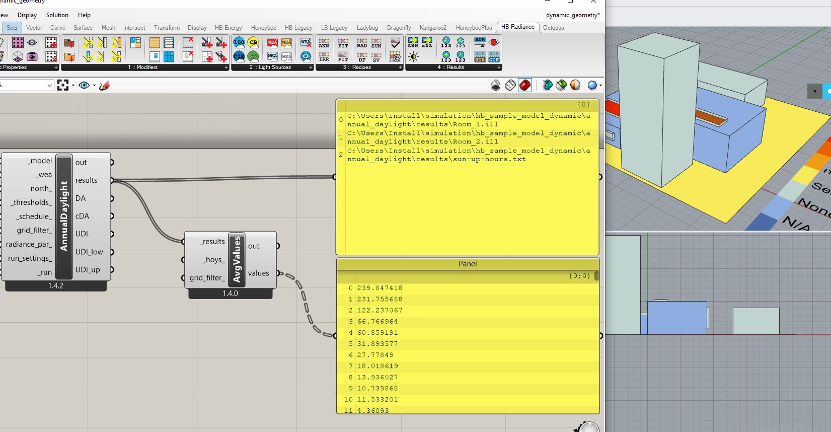

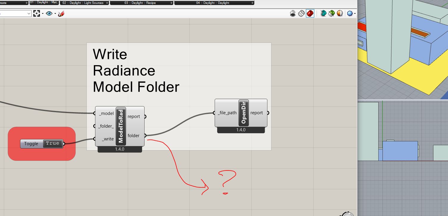

In the sample that you put as a dynamic geometry in Rhino4food, I run annual daylight simulation that this file has different states (window group and shading group); But how should the output of these states be read? There are no traces of states in the outputs. Suppose, in H+, the outputs can be read with different states.
Or I misunderstand this workflow totally.
Unfortunately, there is nothing about this in the forum.
I think a lot of people have this problem too.
Or maybe I do not know where the output of this component should be used !!!
The simulation of the dynamic groups isn’t really supported yet. We have a beta version of a three-phase recipe that can simulate them, which we will hopefully expose shortly.
