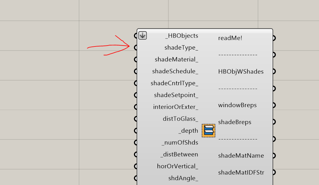

        2 = Swtichable Glazing - represents electrochromic glazing that can be switched on to reflect the material state of the shadeMaterial_.
Thank you very much! Because i am new to Grasshopper all these things seem like a mountain, this helped me alot, i’ll try to figure out the rest :smiley:
Is there by any chance to help with the other steps about the EPwindowshades? Because i cannot fully understand the rest commands.

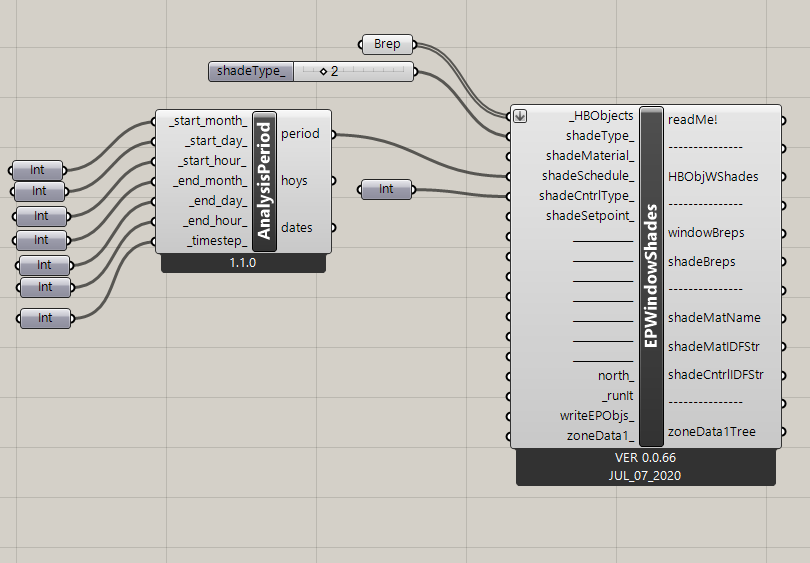

@Kieferguy ,
Here you can find more information.
