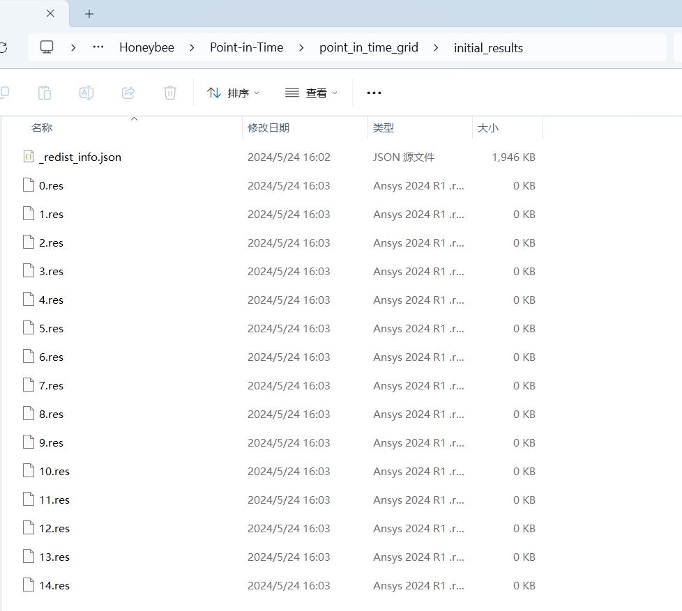

After a while, it failed with RestructureResults(), with empty .res files in the initial_results folder(I used 15 workers)
logs.log (179.9 KB)
But as I checked the debug folder, I found all the 15 folders of “PointInTimeGridRayTracingLoop” did not write anything to the .res files at all.

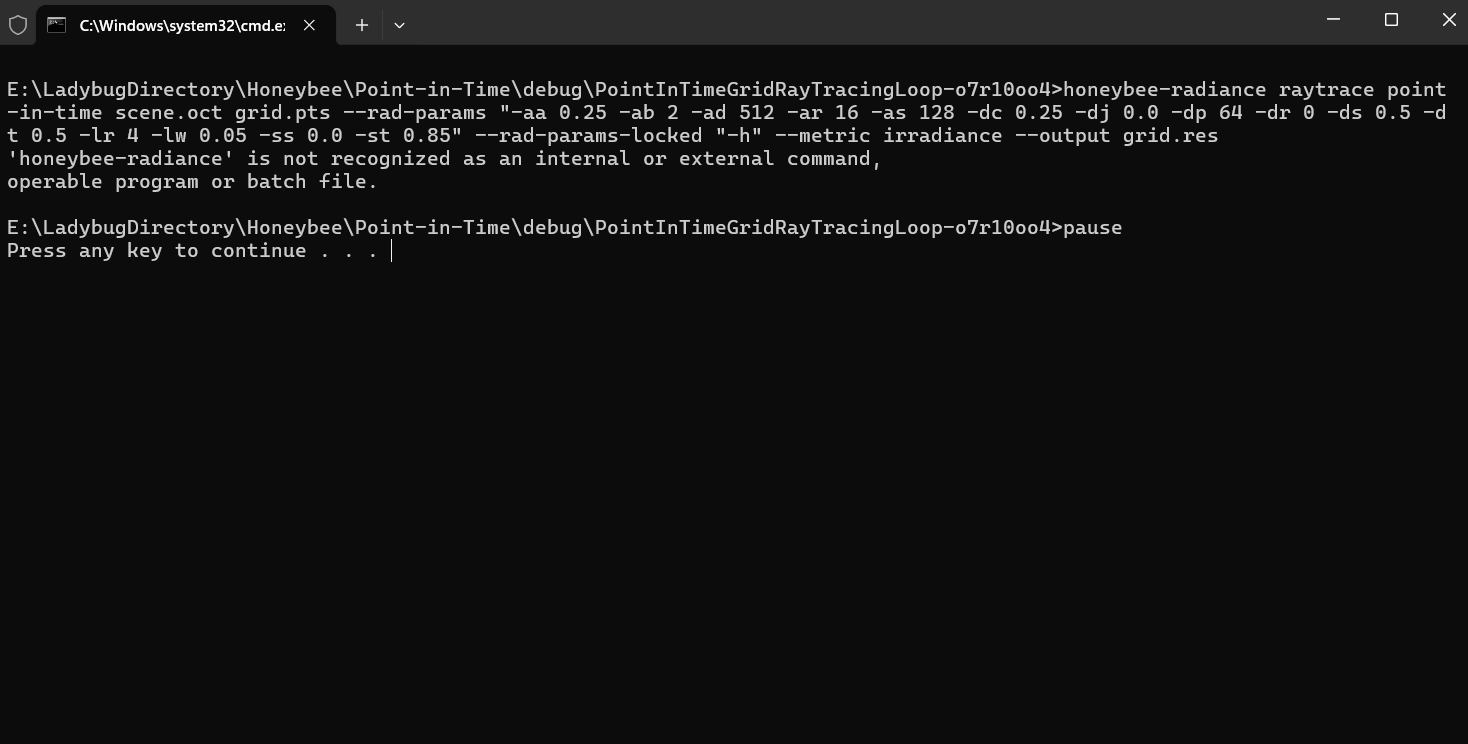

What happens if you run the command inside the debug folder?
Is it working if you are not using Accelerad?

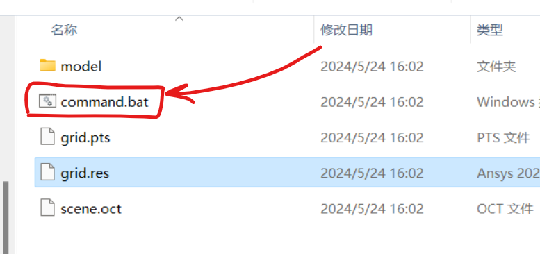

Hi @mikkel , it shows as the picture below. As I press a key, the command window closes instantly.
For the situation I turn Accelerad off, it works successfully.
Is there any conflict between CPU and GPU in such kind of situation? Since I would like to make simulations faster using Accelerad.

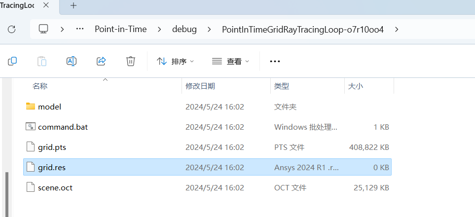

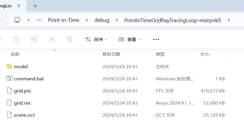

Thanks! Can you zip that folder (any of the “PointInTimeGridRayTracingLoop” folders in the debug folder) and share it with me so I can test it? You can share it in a private message if you don’t want to share it publicly.
For sure! One folder in the .zip uses Accelerad(inside which has an empty .res) and another one does not.
zip
