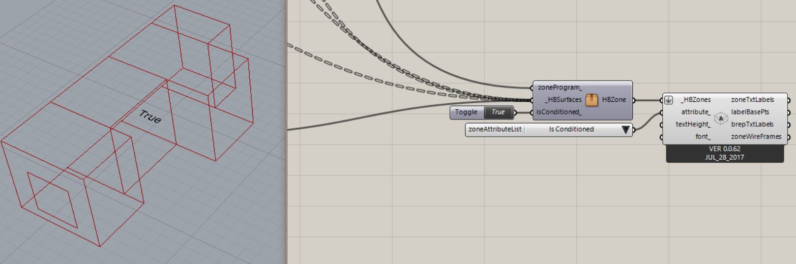

Check if your zones are conditioned. I’m afraid they are not.

Why not?
See image:
