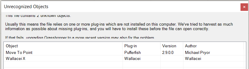

Hi Sima -

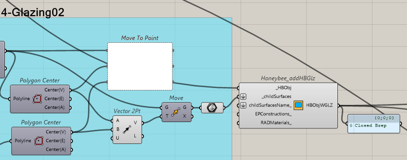

I didn’t get to a Windows machine before now and took a look at your definition.
I think I managed to replace the Pufferfish component with standard components in that WWR group - at least something comes out of the Honeybee_addHBGlz component:

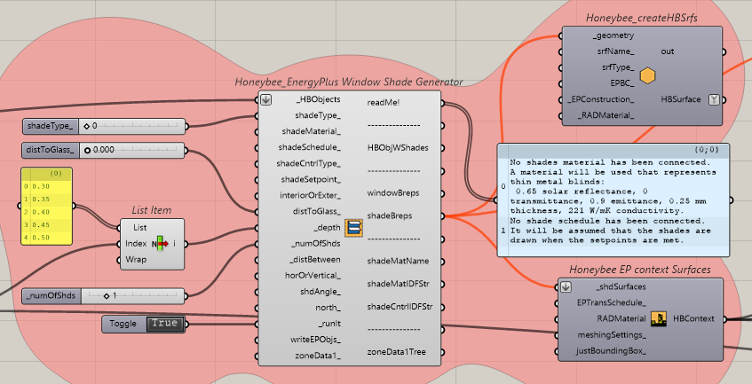

But it doesn’t look that that makes the Honeybee_EnergyPlus Window Shade Generator very happy:
I’m afraid that’s not something I can help you with.
