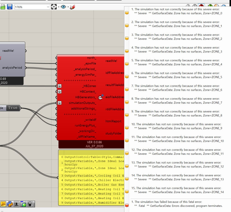

Hello, I am a student studying Honeybee.
I’m watching Chris Mackey’s lecture on YouTube, and I’m posting an error about energy plus while following the example of the sixth course.
As you can see in the picture, the message “Zone has no surface” appears, but I just don’t know how to solve it, so I’m posting it here.
Changing units does not solve the error, so I am posting this. I’d appreciate it if you could give me a solution.
Sorry I couldn’t upload the file because I’m a new user.
Thanks for checking the units. I see that you have updated the component to latest version as well. If you can share a simplified version of your file with necessary geometries internalized then someone will be able to help you.
Try uploading your definition to a cloud service in the meantime and put the link here.
