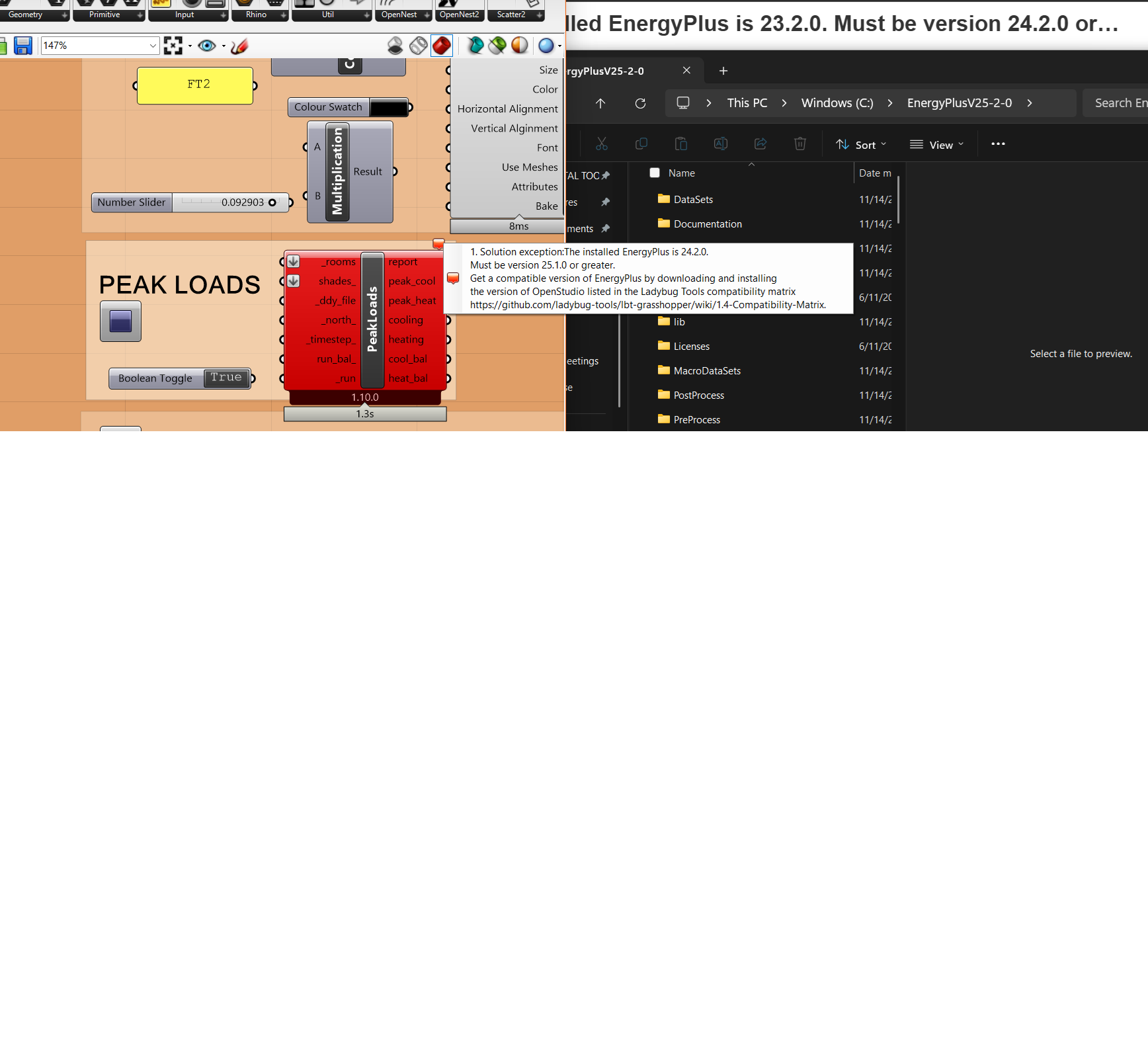

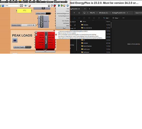

same problem but with 1.10 and energy plus 25.10
